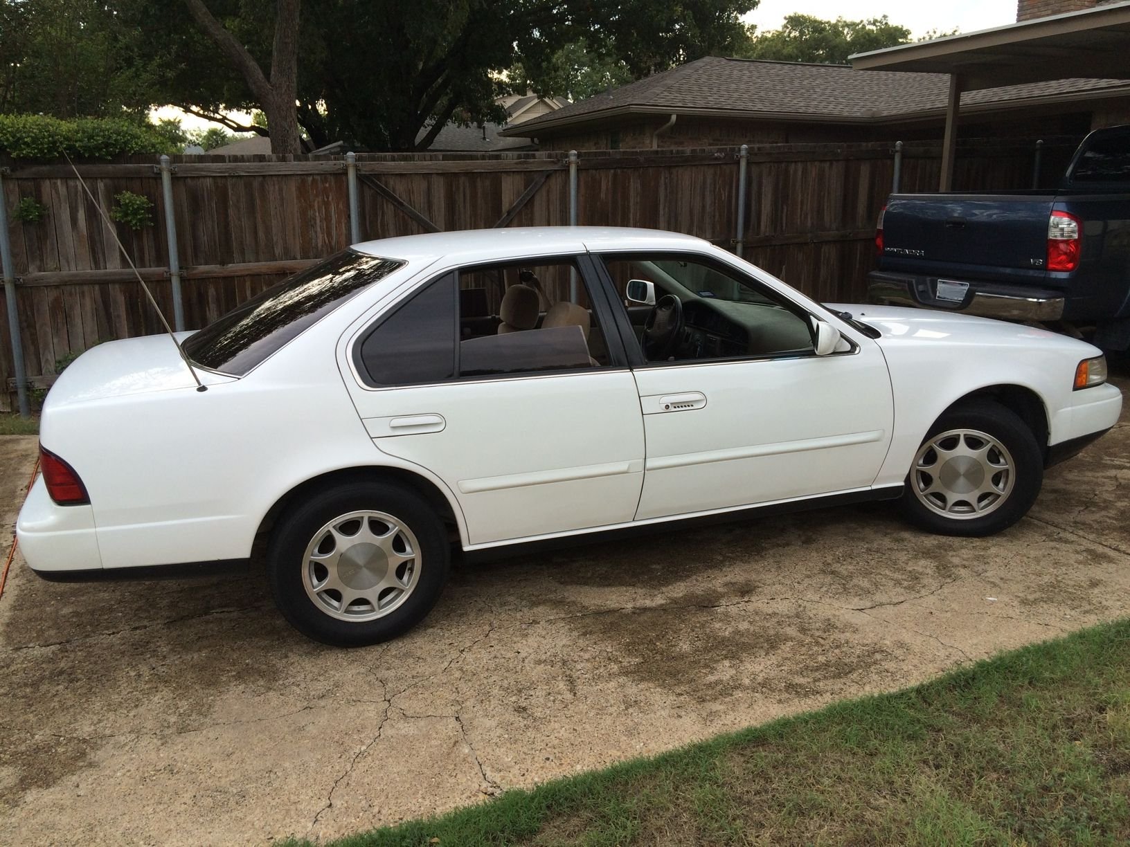

My 94 GXE drivers seat is giving me back pain and sciatica
due to a herniated disk. Seems that since this car is old and the seat probably has lost a little support, I'd like to know what kind of options I have to either improving/rebuilding the drivers seat, replacing w/ an aftermarket, having a pad made that I can sit on and help give a little more "kick" to the lumbar area etc. I still really like this car as it's my spare for when one of the other 2 vehicles go down. I really don't want to sell it since it's so cherry and I probably wouldn't even get $2k for it, but I can't afford more back problems.
Sidenote: My daughter has a '15 Altima with those "Zero Gravity" seats and they are super comfortable. I'd love to put one of those in the old 94, but probably too $$$ and wouldn't fit.
I'd appreciate some input, guys.

Wow that is a nice clean car. You could probably get many different seats to fit but would take some customizing. Just curious and you probably already know but have you used the lumbar adjustment on the right hand side of the drivers seat?
