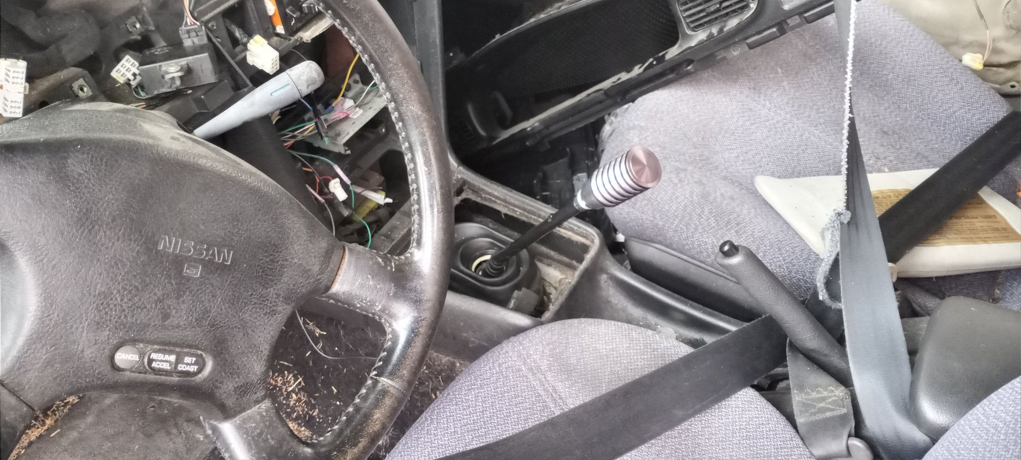

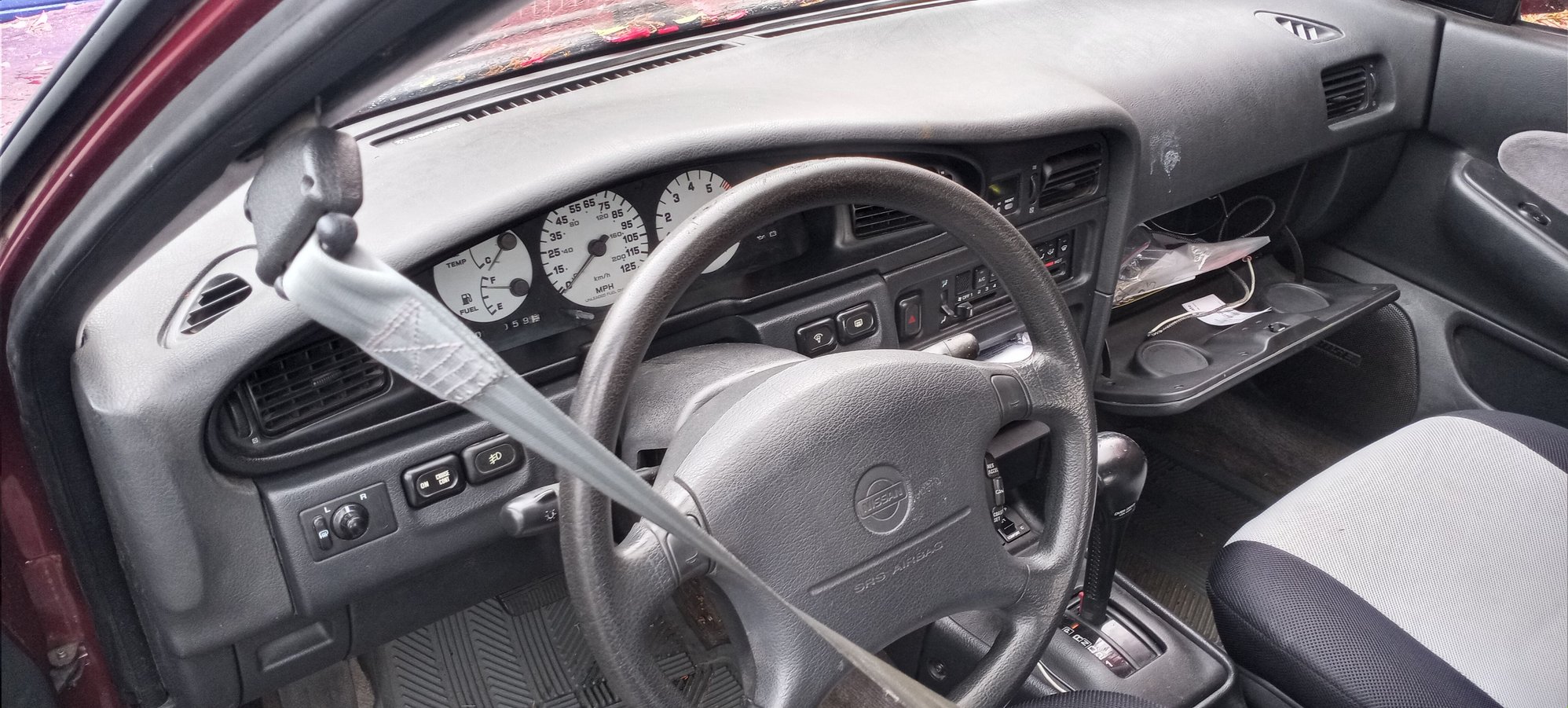

Found a donor 89 se!
We bought an 89 se for $500 that only has 180,000 miles. My son has taken the dash apart to swap his gage cluster out and started removing other parts he wants for his 93. We are going to look into renting a garage/shop and moving both vehicles there so we don't tie up my neighbor's garage for a couple months.
We already have the AT out of my car, and the cv axles are on it so I can move it around. Trying to figure out the logistics of pulling the MT from the 89 and then moving it out of the way to get the other car in, unless I go to a pull and save to get the hub part off of some cv axles is where we are at.
I have the donor to take pictures of before we disassemble, and all the components so likely all I will need to purchase is new hoses and possibly a new clutch. I also have an engine that I will not need, it needs new injectors but other than that looks really good. I also have an engine wiring harness that will *hopefully* work. I may have been had on the restoration of my harness, but now at least I have a chance of getting Maxhuck running again!
Donor car!
Donor car!
5 speed!
5 speed!
Nitromaxx's new gage cluster.
