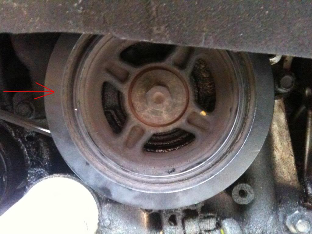

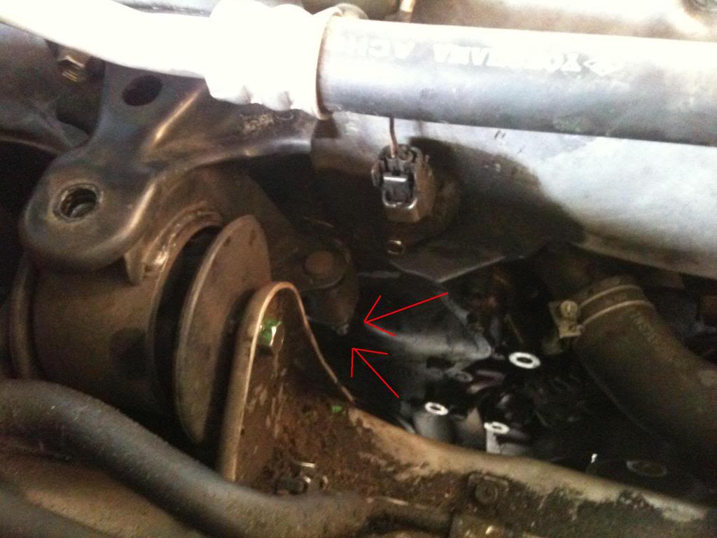

I am trying to change out my water pump, the how to's here on the org made me believe that while difficult, I could do this. Well I cannot get one of the motor mounts bolts to come off, I have already broken 2 u-joints because I cannot get flush on the nut. (see picture below)
I could get to it easier if this wheel was not in the way (see pic below)
Is it safe to remove that for easier access? or should I avoid messing with it to prevent further issues.
If it is better to leave that alone, is there a better what to get to the timing tensioner? Some posts say motor mount must be removed others say it doesn't have to, I don't see how it can be done without removing it.

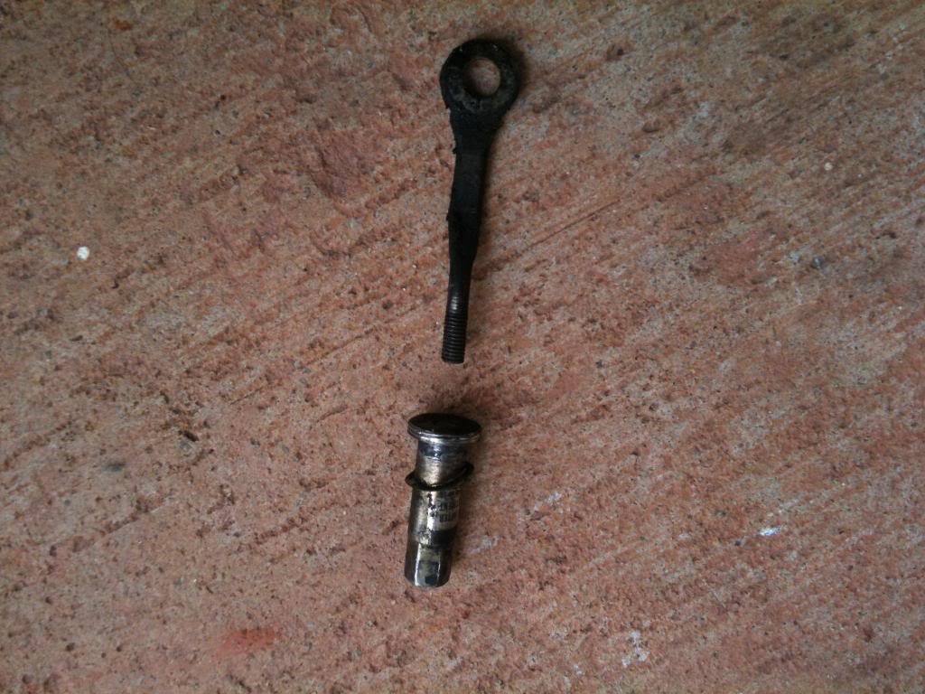

in addition to that, while i was removing the alternator tensioner pulley I think i broke the bolt adjuster (shown Below)
I will need a new one of those correct? I mean are those 2 parts supposed to be welded together as 1 part?
any help is beyond appreciated, I think I am in way over my head and have posted for help in the regional section, but If i can do this myself I am going to keep at it. thanks in advance.
You can get to the timing chain tensioner without removing the mount, it just makes access a bit more difficult. If you remove the PS reservoir, you'll have enough room to sneak back there. Personally, I always remove the mount, should only take a few minutes, and makes it that much easier.
The belt tensioner bolts are common to seize up and break if they haven't been touched in a long time.
If those are your only two broken parts, then all you need to order (or get at a junkyard) are these two part numbers:
11948-31U00, $12.08 at Courtesy
11934-31U00, $6.27 at Courtesy
You could remove the crank pulley to get a little more room, but it's entirely unnecessary. Personally I've never had a problem removing that nut with a deep socket and an impact swivel (haven't used a u-joint in a very long time, they're more prone to breakage).
