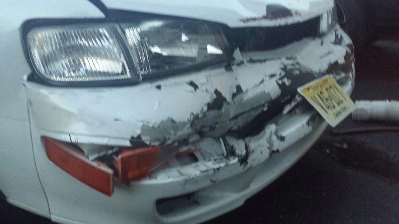

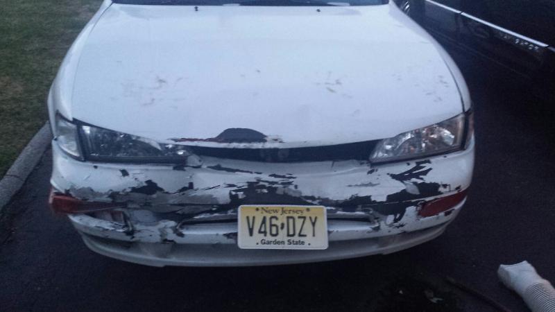

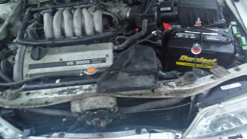

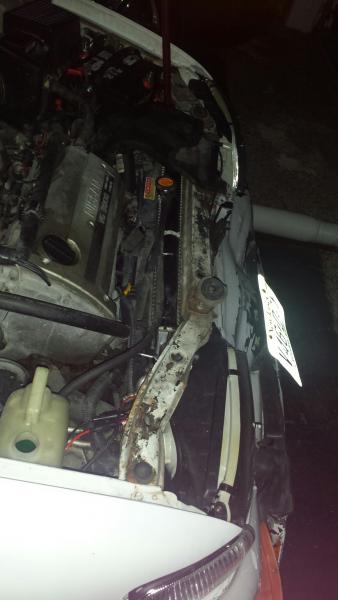

what do you guys think??
My girl and I just got this and have had it for just about a month, she got into a front end acc and well the pictures speak for themselves,, imo if we were to take it to a body shop they'll most deff charge a good 1300 - 2500 to get it fixed….. What do you guys think??? how much do you guys think it'll cost?? Is it even worth it?? its a 97 with 105k
Attached Thumbnails NOOBIES: "I AM NEW HERE BUT HAVE A QUESTION" thread. Read FIRST post BEFORE posting!-image-1.jpg   NOOBIES: "I AM NEW HERE BUT HAVE A QUESTION" thread. Read FIRST post BEFORE posting!-image-1-2.jpg   NOOBIES: "I AM NEW HERE BUT HAVE A QUESTION" thread. Read FIRST post BEFORE posting!-image-1-3.jpg   NOOBIES: "I AM NEW HERE BUT HAVE A QUESTION" thread. Read FIRST post BEFORE posting!-image-1-4.jpg

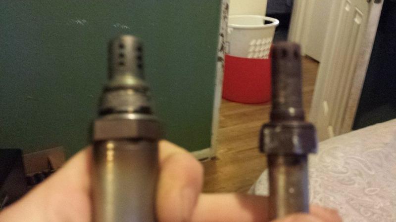

o2 sensor help
Well, I've been working on replacing my o2 sensor on my 97 GLE maxima. The previous owner had the wrong sensor on and was not connecting to the computer. adapter had 3 prongs rather then the 4 needed to connect. I finally was able to take the old one out after purchasing 22mm o2 sockets that didn't fit i realized it's a 17 mm bolt on the old sensor. The new part I purchased from amazon
Amazon.com: Bosch 13273 Oxygen Sensor, OE Type Fitment: Automotive Amazon.com: Bosch 13273 Oxygen Sensor, OE Type Fitment: Automotive
is actually too thick to fit into the o2 thread. I am trying to figure out what sensor I need that will actually fit. In the photos I show the 4 prong adapter that goes to the computer. and I show the size difference from the new part (that doesn't fit) compared to the old one (that fit) the thicker is the newer part.
Attached Thumbnails NOOBIES: "I AM NEW HERE BUT HAVE A QUESTION" thread. Read FIRST post BEFORE posting!-10256824_580948352013112_6664034277647365211_n.jpg   NOOBIES: "I AM NEW HERE BUT HAVE A QUESTION" thread. Read FIRST post BEFORE posting!-10250127_580948362013111_4344118381032843050_n.jpg
I'm thinking that's a $4K to $5K repair. I wouldn't bother repairing it at that price.
The only way to reduce the repair cost would be get parts from a junkyard and find a guy that does body work out of his garage. I did that for a crunch I had and took a $3500 body shop down to $1500.
But the challenge is to find a good repairman, that's the hardest part.

Originally Posted by Rivers
Well, I've been working on replacing my o2 sensor on my 97 GLE maxima. The previous owner had the wrong sensor on and was not connecting to the computer. adapter had 3 prongs rather then the 4 needed to connect. I finally was able to take the old one out after purchasing 22mm o2 sockets that didn't fit i realized it's a 17 mm bolt on the old sensor. The new part I purchased from amazon Amazon.com: Bosch 13273 Oxygen Sensor, OE Type Fitment: Automotive is actually too thick to fit into the o2 thread. I am trying to figure out what sensor I need that will actually fit. In the photos I show the 4 prong adapter that goes to the computer. and I show the size difference from the new part (that doesn't fit) compared to the old one (that fit) the thicker is the newer part.
I am guessing that you want to replace the sensor that is mounted after the catalytic converter.
I don't know what the Bosch numbers are. The one that you got from Amazon may be for the 95 & 96 cars.
But if you go to Rock Auto and get the Denso brand # 2344716, that should do it for you.
http://www.rockauto.com/catalog/x,ca...,parttype,5132
That's where my problem lies. that part doesn't fit, it fits the harness connector but doesn't fit into the o2 sensor housing. The problem is it's too thick. I saw that 96 sensors look the correct size for the housing but I can't find a 4 wire one.
Essentially I need this size sensor with a 4 wire harness connector.
http://www.rockauto.com/catalog/more...453&cc=1211410
Will I end up having to get a new catalytic converter? or could I change out the o2 harness connector? If I have to replace the catalytic converter anyone have any ideas of a decent cheap one to purchase?
I'm confused. The photo of the sensor I posted uses a 4 wire connector and it is the smaller size. The only difference between the one that I posted and the one you posted is the brand.
Is the brand what you are objecting to? I was just trying to match the price of the one you bought off of Amazon. If you prefer Bosch, so be it.
When was your car built? there was a change in 06/1996. I didn't think any 97s were built with that date.
But since you don't currently have the correct O2 sensor, you will have to get another something. An O2 sensor will be a lot less less than a catalytic converter. If you get a cat that fits, it will be pretty darn expensive. A universal cat will be maybe half the price but you will need to get it welded in and get an O2 bung put in.
They are a different size. they look very similar but if you look at the thread on both one is a bit smaller. I talked to a shop and am about to head to an exhaust shop and see if they can weld a bigger and correct size bung on my cat. Have to find one that's willing to work around some legal catalytic work. I'm not exactly sure when it was built but it is a 97. I appreciate you looking mate hope I can get this done and over with before my trip permit is done and without breaking my bank.
Went to a couple shops looks like my only choice is to get a new catalytic converter. Pretty sure I'll be purchasing from rock auto looking at this cat http://www.rockauto.com/catalog/more...354&cc=1211443
I really didn't want to spend so much just to get an o2 sensor working but it's keeping me back from passing deq. But with the help of this site I also replaced the knock sensor for little to no money so I guess I'm breaking even since some shops wanted somewhere round 400-500 $$$ for the ks.
It seems seems strange (to me at least) that you are willing to spend big dollars to make a small dollar part fit. It should be the other way around.
You could take the original O2 sensor to a loacal parts store and compare with a new one before you buy it.
But since I probably don't know all the details, all I can do is say "hope this is the end of your problem".
