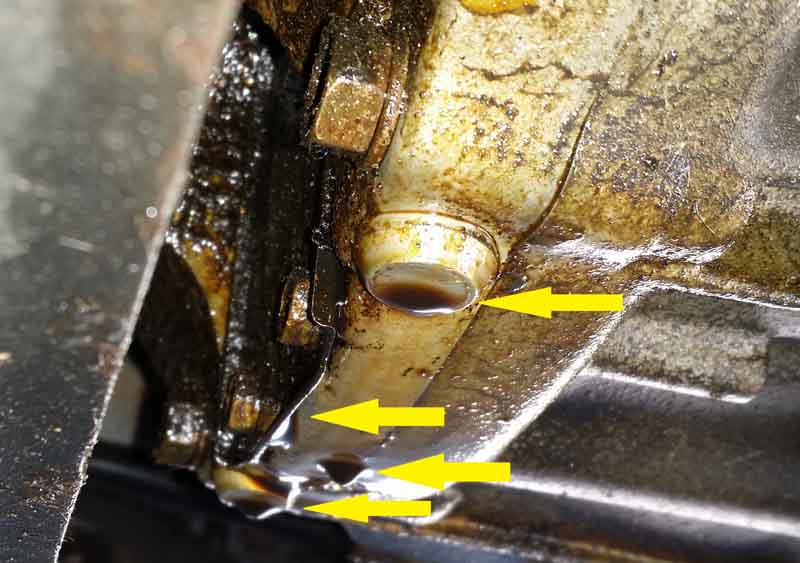

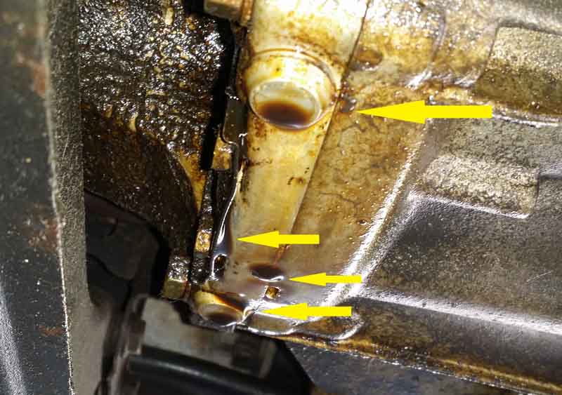

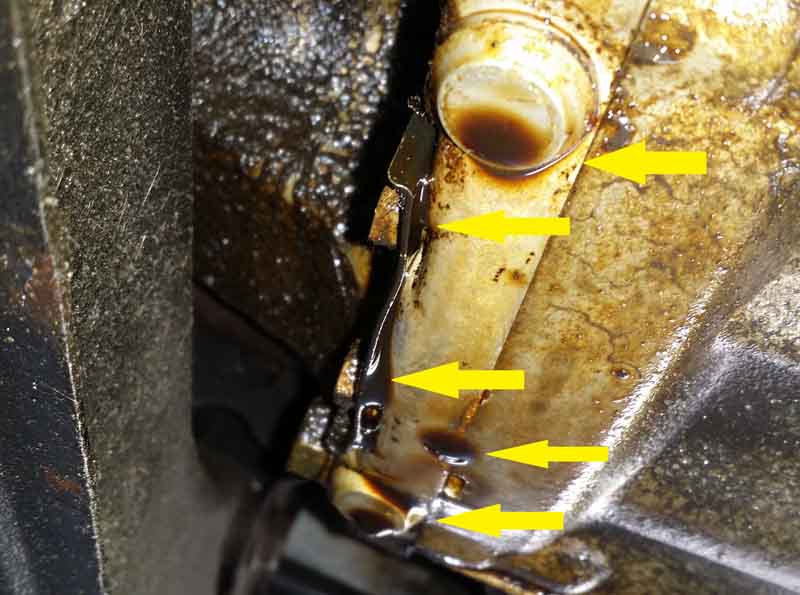

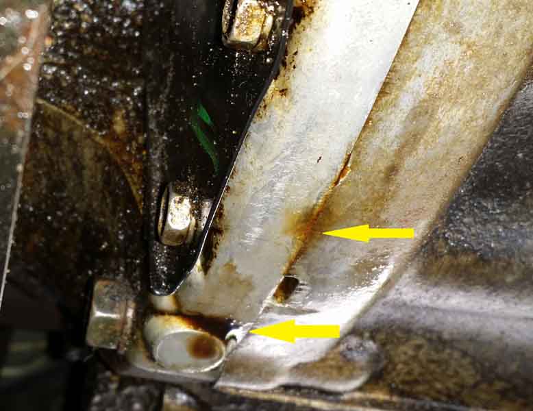

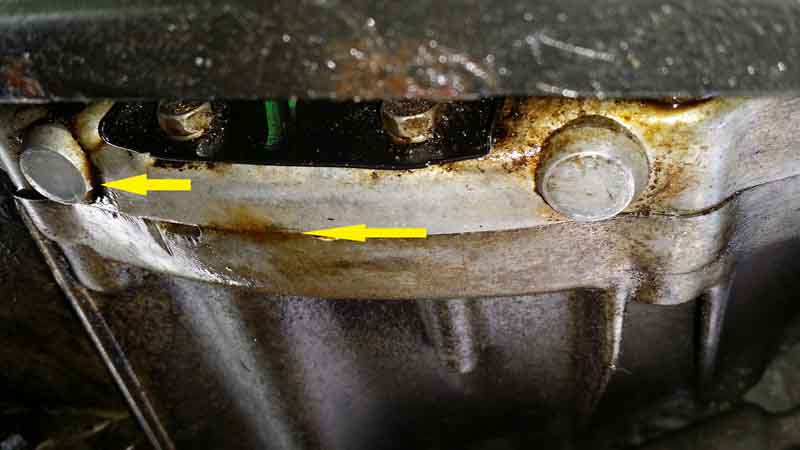

Too bad I missed this before I bought the car. Looks like I'm leaking around the rear main seal. Seeping around the two bolts, behind the thin plate (whatever that could be), and right where the engine and tranny come together.
In the first 3 images, I took pictures of where it looked like it was leaking. Then for the last two pictures, I wiped the area down, started the car and let it run for about 5-10 while I was under it so I could see the seepage for myself.
Since this is going to be an expensive fix, and I don't have the money to fix it, my only other option is to re-sell the car that I just bought.
Unless someone has got some other advice. I'd like to keep the car, but the purpose of buying it is to drive it. I'm not sure if I should be driving around with it leaking that bad. I checked the engine and tranny fluids right after taking these pics, and they both were fine.
