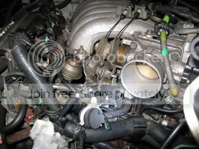

Are you throwing any codes?? You could start by cleaning your throttle body and IACV.

Check yuor codes, then proceed. After that, clean your TB & IACV.
Stopping jumping to conclusions about injectors, etc until you know what the problem is, and that is what the error codes are for.

No I have a question. I am replacing my KS and you see how little space I've got on my 99 Calispec Max. So #2 on third pic is in a way. I was told that it is power valve actuator and con be removed(my friend doesn't have it on his 96 fedspec max). Now to put it back do I need to torque the fasteners, put anti-seize or other type of gel.
Can someone navigate me to a proper section of the FSM for it?
Thank you guys again.
