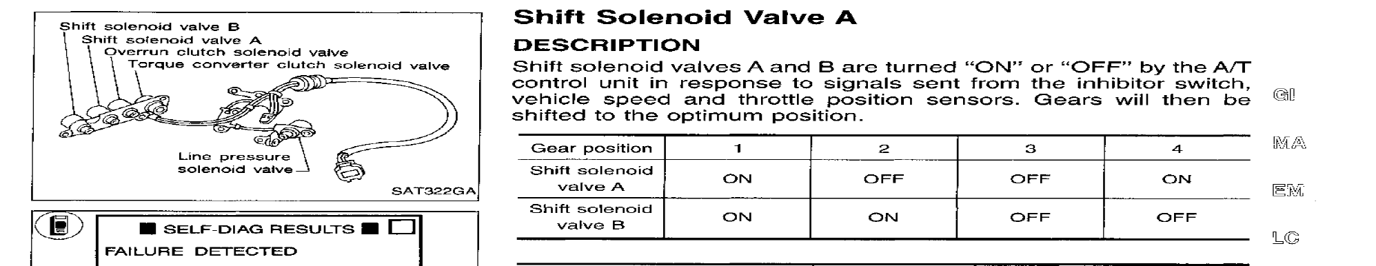

There's a solenoid kit for the RE4F04A out, the original parts apparently aren't all that great. I swapped out the solenoids in my third trans and it acted great until all the damage already done to it caught up and killed it. WOT 5500 RPM @ 10MPH FTL. Clutches welded themselves together, no friction material left at all.

Your AT seems to enter Fail/Safe (Limp mode). It is always in 3rd gear regardless of shift selector position. The mode can be triggered when it detects erratic shifting (spin wheels then brake). Per fsm, then, it can be reset by turn key to OFF for 8 seconds then ON. But if there is internal error, then you must perform self-diagnostic steps to find the trouble codes and go from there. 100-120kph (60-75mph) seem to be the right speed range for the gear, go faster than that the engine will work harder (rpm?).
Transmission is the most complicated part of a car. There are lot of sensors (electrical), and solenoids (hydraulic devices) sending signals to or take command from A/TCM and ECM to control the shifting.

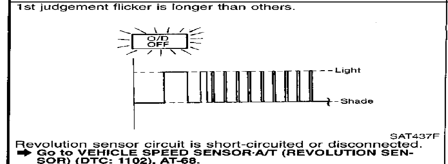

so why is it sweet as soon as its warmed up and its not every time but id say 70% of time safe mode till about 2mins or till the temp gage in car moves
also did a diagnostic on it and comes bak no codes 1 long 10 short flashes ive read up about temp sensor resistor or the solenoids should i ohm test these ?? if so what are thay ment to b ? if it is whatst he restor mod some people use ?

no codes at all speed sensor works all gd but i see theres a temp sensor on the tranz could this b it ? is it true is this reads wrong the car puts more gas in to heat up the cat converter ? if so it would explan the sudden gas jump as it uses heeps now if this is the prob how do i test it where is it found and what should it read when testing ?
A/T fluid temp sensor can put car in limp mode if it is open/shorted or give incorrect voltage. At 20C/68F, voltage should read 1.5V, and when warm up 178F it should read 0.5V. This voltage is measured at TCM between pin 33 & 35.
The sensor is/seems to be in the AT oil pan. The resistance is measured at the sub harness. Resistance should be 2.5KOhm@20C/68F (key off, connector unplugged) between pin 6 & 7 of the F42 connector (an 8-pin connector). From the map, it is located near VSS sensor connector (F43) or near revolution sensor connector (F41).
Don't forget to check fsm (AT.pdf) for more detail on code P0710.
