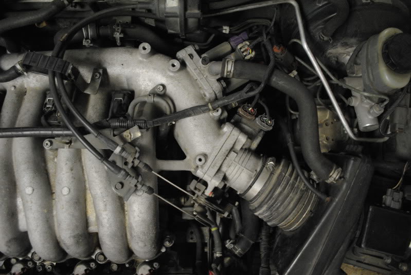

old block and intake - and I should probably mention I used the intake from the I30 onto the maxima calif block....

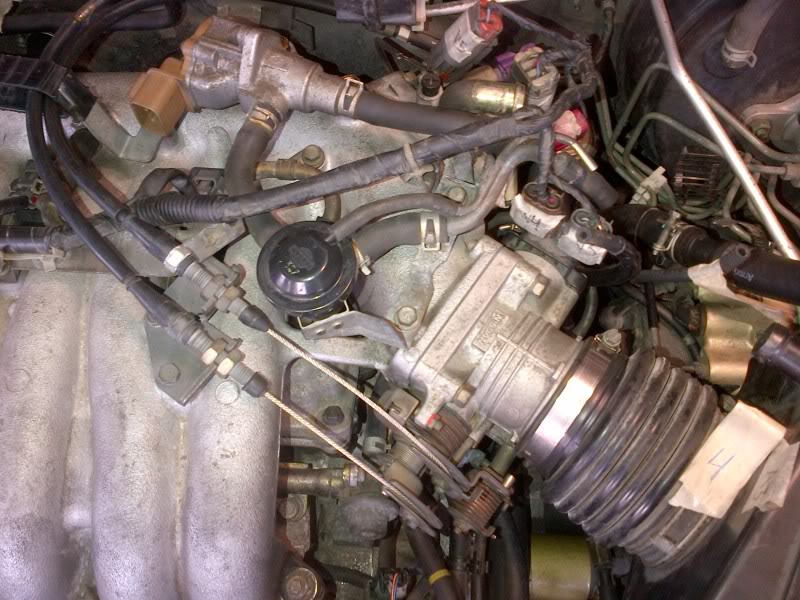

old (I30) intake with Calif equip bolted on>>I'm guessing I should just remove all the calif equip and use existing ...

Use block and heads from the motor from lkq. Use everything that bolts to the intake manifold and exhaust manifold from your old motor.
