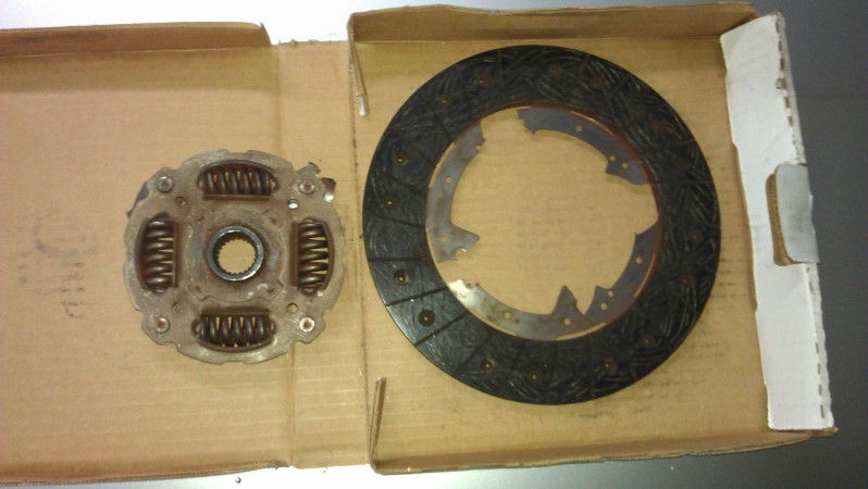

This was my 5th gen clutch after a year and a half or so.
