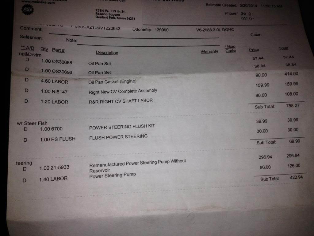

Just got car back from mechanic. Oil pressure sending unit is fixed. He confirmed that my valve covers are not leaking.
What he said needs to be fixed:
Passenger side CV axle; boot has a tear, no more grease. I am pretty sure I've heard what sounds like a worn axle/wheel bearing when I reverse slowly and the wheels are turned, so definitely needs to be done.
$160 - Right new CV Complete assembly
$108 - labor
$270 - total
Power steering pump/flush:
$297 - reman pump w/o resevoir
$126 - power steering pump
$493 - total
New upper oil pan gasket: this one pisses me off. Ive heard they're a ***** and a half. 4.6 hours of labor.
$37.44 - gasket
$38.84 - gasket
$414 - labor
$490 - total
Obviously the cv axle and oil pan gasket are most important. I'm a broke *** college student (3rd year mechanical engineering technology major) home on spring break. I'm mechanically inclined, and have done my fair share of wrenching. I am slow, but am capable of these jobs. When I am away at school, I have absolutely no time, tools, or space to make these repairs. I am currently home until sunday, have SOME tools, but not all of them that I need.
Alright ORG what is your opinion on what needs to be finished first? I will most likely start riding my bike everywhere at school now...
$108 - labor
$270 - total
$493 - total
$37.44 - gasket
$38.84 - gasket
$414 - labor
$490 - total
Here is a good writeup on the upper oil pan resealing
http://forums.maxima.org/4th-generat...n-removal.html
I've done it, was not too bad of a job just kind of time consuming but never came across anything that stumped me or that I had trouble with. Did that several years ago when I was pretty new to fixing cars and didn't have a ton of tools. After resealing the valve covers and I still had a leak I thought it was the upper oil pan leaking. There are only 2 small half moon seals and the rest you just use RTV sealant. Fixed that and that didn't solve it either. Turned out to be the 2 orings between the engine and the inner timing chain cover that were leaking. That was a ***** of a job especially with the engine in the car. Not really too difficult if you make sure you follow FSM step by step was just very time consuming.
Axle is pretty easy to only a few hour long job if everything goes good. You can get one from autozone for around $70 I believe and you can also rent the large 36mm socket to remove the axle nut from them.

Wow, judging by just those three alone I have already saved a freakin' ton of cashola doing my own work, not to mention the absolutely countless other things I have had to fix on this car that you don't show...yet.
Why are you being charged for a power steering flush kit? Any reputable shop should be able to do a drain and fill without the extra bullsh#t charge. Besides, a power steering pump only costs $155.79 at Advance, sounds like your being ripped off on parts costs as well.
You can go through http://www.rmdriveline.com and get handbuilt axles (made right here in the U.S.A.) for only $69 each, I ordered mine through them and they work great, axles are easy to install yourself and these are completely gone through with new joints, boots, clamps, and balanced properly.
Not sure what the deal is with the gaskets, OEM parts only cost $8.44 each for the U-shaped ones and $14.15 for the liquid gasket when you go here www.nissanpartszone.com
Good luck, it's definitely worth your time to do yourself if not just for the savings but the knowledge.
