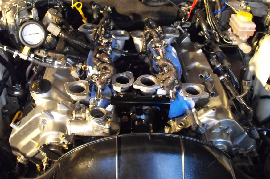

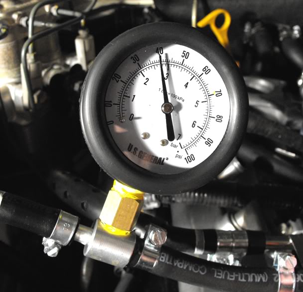

Is there any way that you can run a fuel pressure test? There are inline fuel pressure testers that you can put in the fuel line between the fuel filter and the fuel rail.
This is a different kind of Nissan in the picture but the same principle for running a fuel line pressure test below.
If we can get an idea of the fuel pressure going to the injectors, then we have a place to start.
Also, there is a fuse for the fuel pump inside the fuse panel. I often pull the fuel pump fuse to keep fuel from being dumped into the engine during a compression test.
You may want to check FSM section EC for diagnostics.
