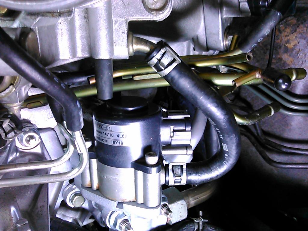

The hose being removed at 13:23 allows coolant to flow through the throttle body to the EGR. I have 99 models with the electric EGR valve instead of a vacuum controlled EGR on the 95 model. So my EGR will look different.
Here's a picture of the coolant hose running from the throttle body to the EGR.
Does this help?
