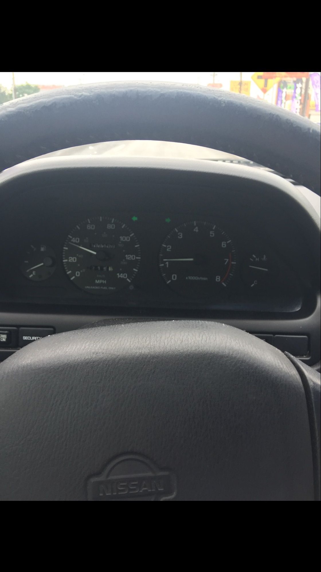

The tempature gauge should always be a little below mid line at all times when driving at any speed or in idle correct? From what I am experiencing is not normal right? Which is the gauge needle creeping up to 75% the after a few seconds of moving the car. And then going back down to 50%

This is normal tempature and should at be here at all times correct?
This is where the needle is when I'm driving:. When I slow down or come to a stop it goes a little over middle. describing the normal line as of now on picture 2 on first post

Does not look normal. Do you have wetness near the water pump?
Radiator leaks or steaming?

The sensor appears to work. It is responding to low coolant levels.
