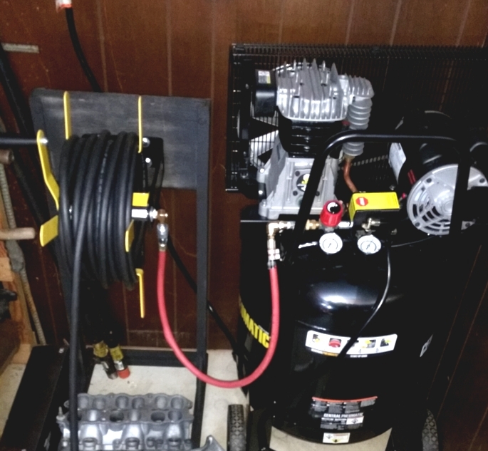

Finally - After a trip to the salvage yard, and seeing a number of purge valves and solenoids that were full of charcoal, I found the issue to be a combination of clogged purge line and valves that were chocked full of charcoal.
The purge line clog was so tight that it took multiple tries with 125 lbs of compressed air to break it up so that air would pass freely through the purge line.
I disconnected the purge line at the charcoal canister, then disconnected the purge line in the picture below to hook up my compressed air nozzle.
I don't know how anybody could break up this type of clog without having access to a large air compressor. The old canister, in addition to being full of mud, allowed charcoal to pass into the purge line where it caused a clog. The previous owner must have been battling the clogged line and replaced the purge valve solenoid with some aftermarket valve. I replaced the purge valve solenoid and valve with OEM versions that I picked up at the salvage yard for less than $20.

Here's a picture of the air compressor that I used to break up the charcoal clog in the purge line. It took several tries with a high pressure nozzle attached to the purge line to finally break up the clog.
After clearing up the clogged line and replacing the purge valve and purge valve solenoid I took the car on trip and no codes appeared.

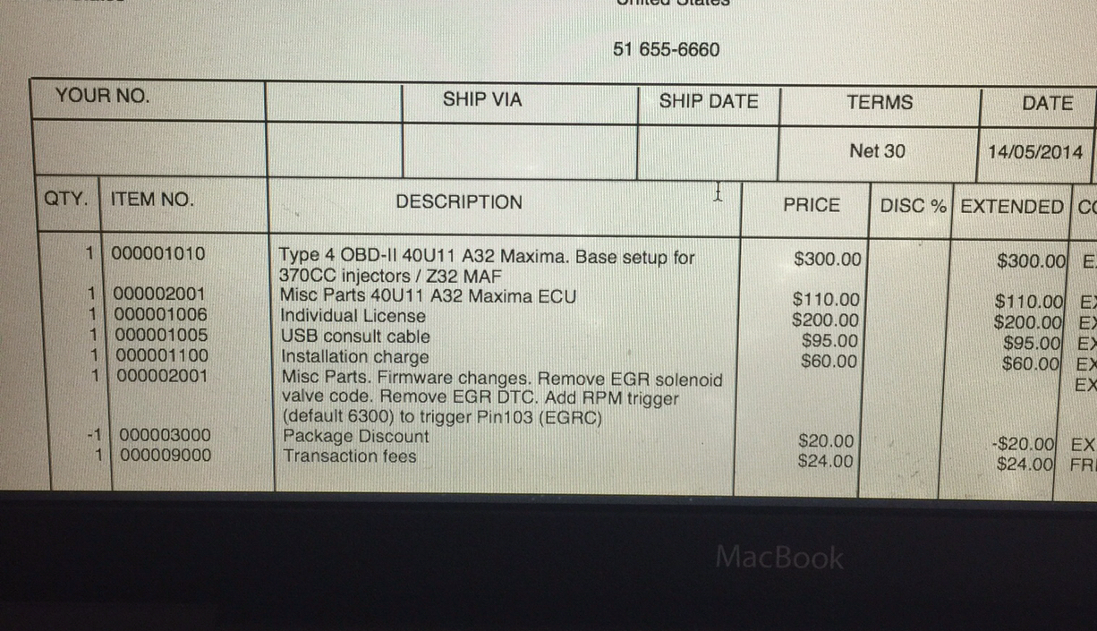

I did the 3.5 swap Super charged, 570cc injectors, and did the EGR delete in my Nistune. I’m still getting a code for EGT, I didn’t even node we had a sensor for that. Can’t pass inspection till I get this figured out as well.

I had my EGR code deleted by Mat at Nistune. You won’t be able to permanently delete any codes unless it’s written in your ECU. Reach out to Mat at Nistune over sees. If you need a new consult cable, Andy at Autovahn can get you one I believe. He’s a local Nistune distributors in the US.

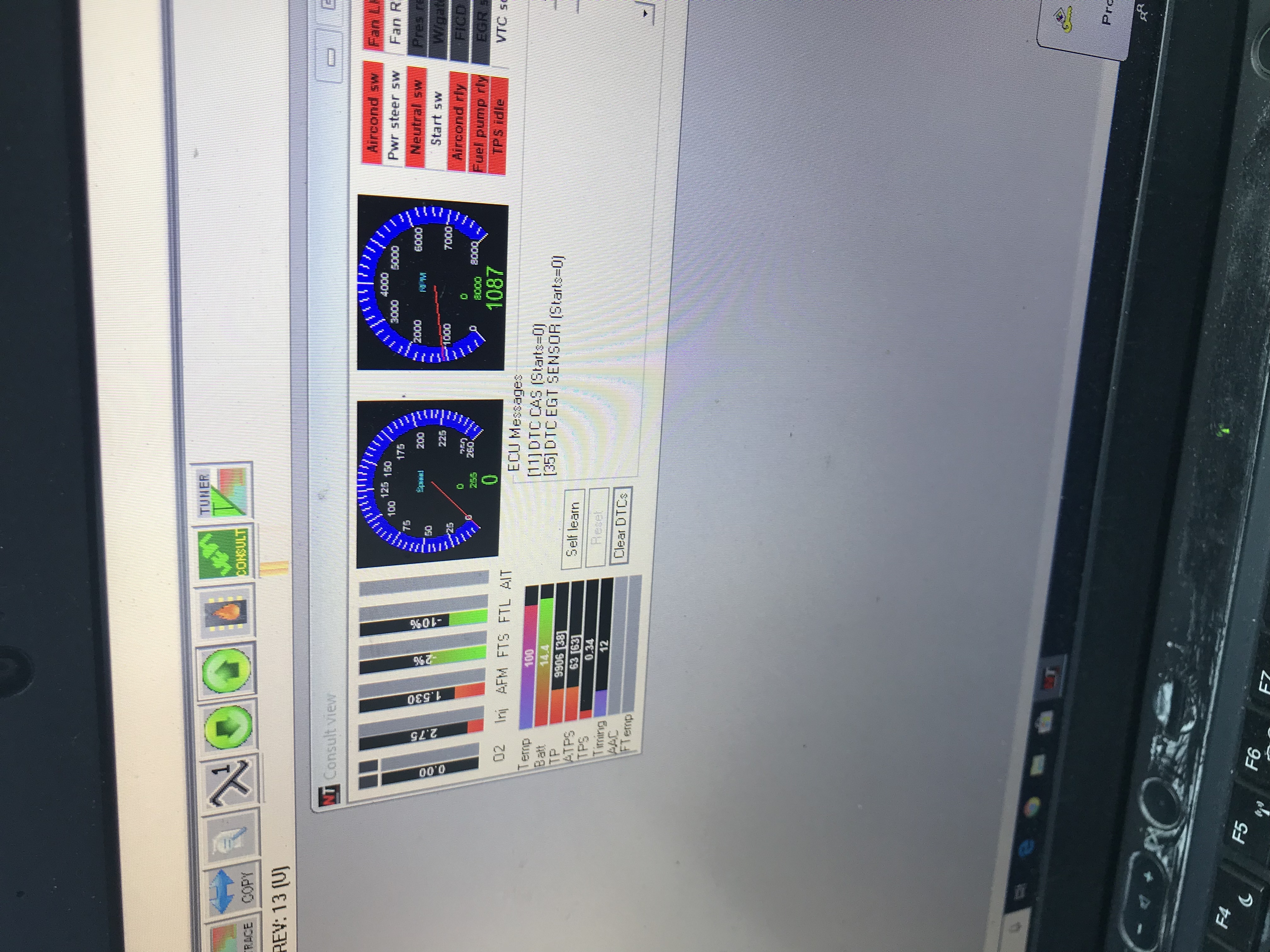

Any idea why I would get and EGT code? I have my ERG blocked off at the manifold and had the EGR code deleted.
There is a section listed in expert mode (change this in the configuration if you need to) the left hand side where the maps are towards the bottom there will be DTC Filtering in one of those I saw EGT listed with a checkbox
I got a concept Z consult cable for $75 and bought my Nistune board from tuner wizard for $250(they upped it $10 or $20 afterwards) and it was shipped directly from Nistune
Installed the board myself without desoldering and just using some quality solder flux leftover from my Xbox 360 mod chip business before I was old enough to have a license. Pretty sure that stuff is cancerous and not produced anymore but the RadioShack flux was **** in comparison
If the EGT option doesn't remove it then try the crankshaft sensor in Register 4.
I've opened my bin file in another file editor to see how turning on and off the filters works. OBD2 Pxxxx formatted codes are already in hex form (P1446=1446 in hex) so you can easily open the bin files and do a search for a specific code. Then you can see the address it writes to in the bottom left of nistune when you select a filter and also the "Main" (value) that is entered in at that address. The TPS, Fuel Temp Sensor, and the IAT DTC codes are listed in Hex in the same exact order as they are in Nistune Filter Register 4. The filter options are identical for all cars with different selections made by default, I'm thinking the one size fits all options may not be completely accurate, the filter registers go in order in hex and also the address each register changes are all in consecutive order.
If I'm right and the registers just aren't one size fits all then I can just do a little finger counting to figure out which address I need to modify for which DTC and modify it to the value that deselects that DTC. If not when Matt is awake in Australia maybe he can do in 5 minutes what I spent an hour and a half trying to figure out how to do. It must be nice to have all the answers
