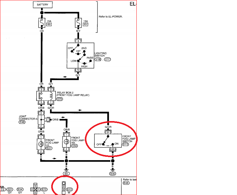

I guess you don't need stalk. I think the fog switch on the stalk just jumps pins 31 to 32 of E113.
