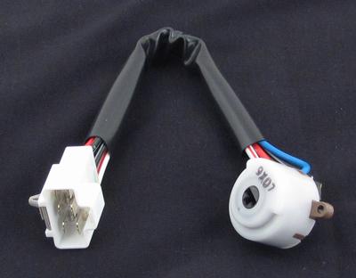

Here is a photograph of the actual part -

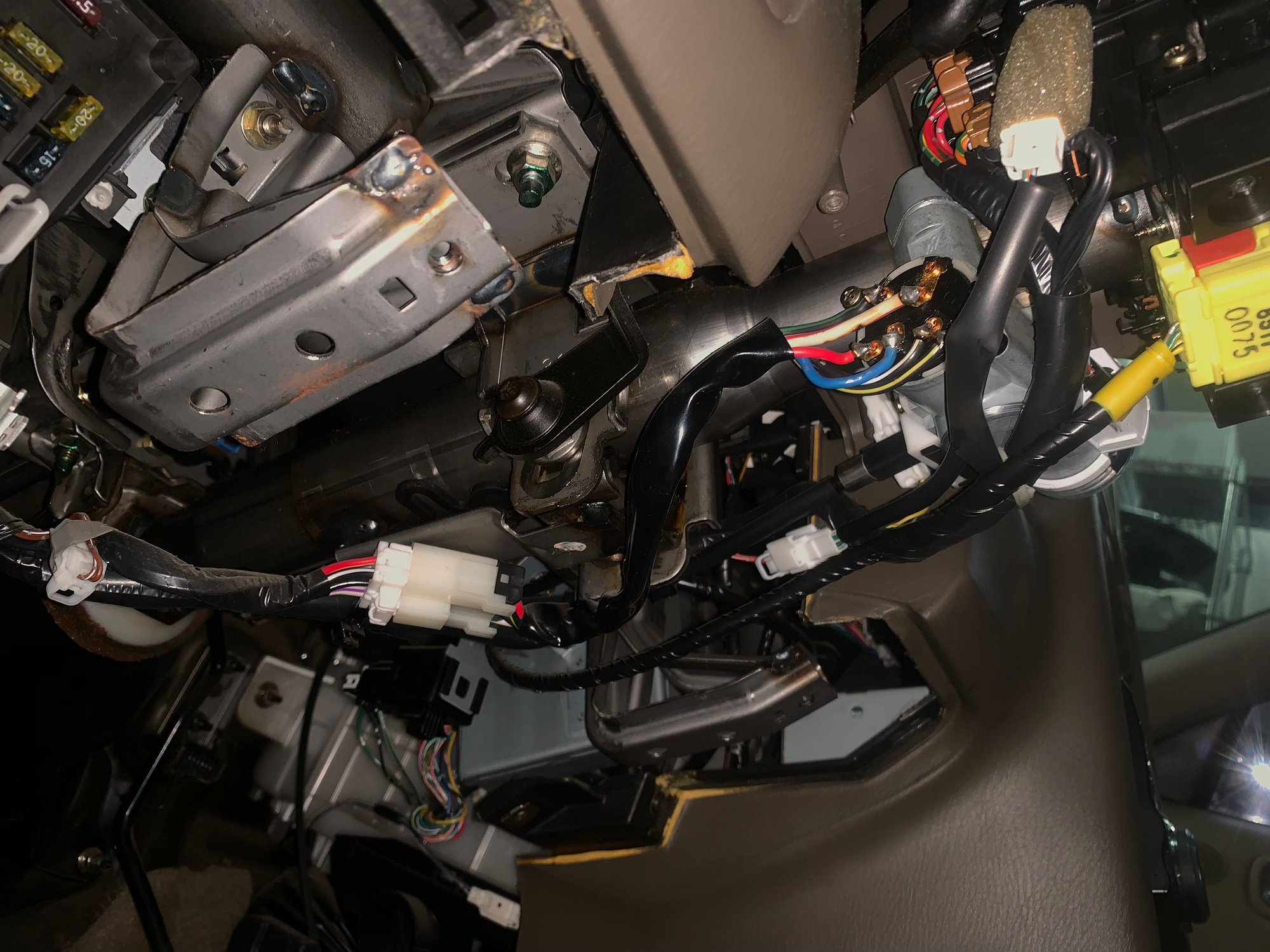

The under-column pic is of the old switch as installed - check out the burn marks on the white/red and green/black wires.

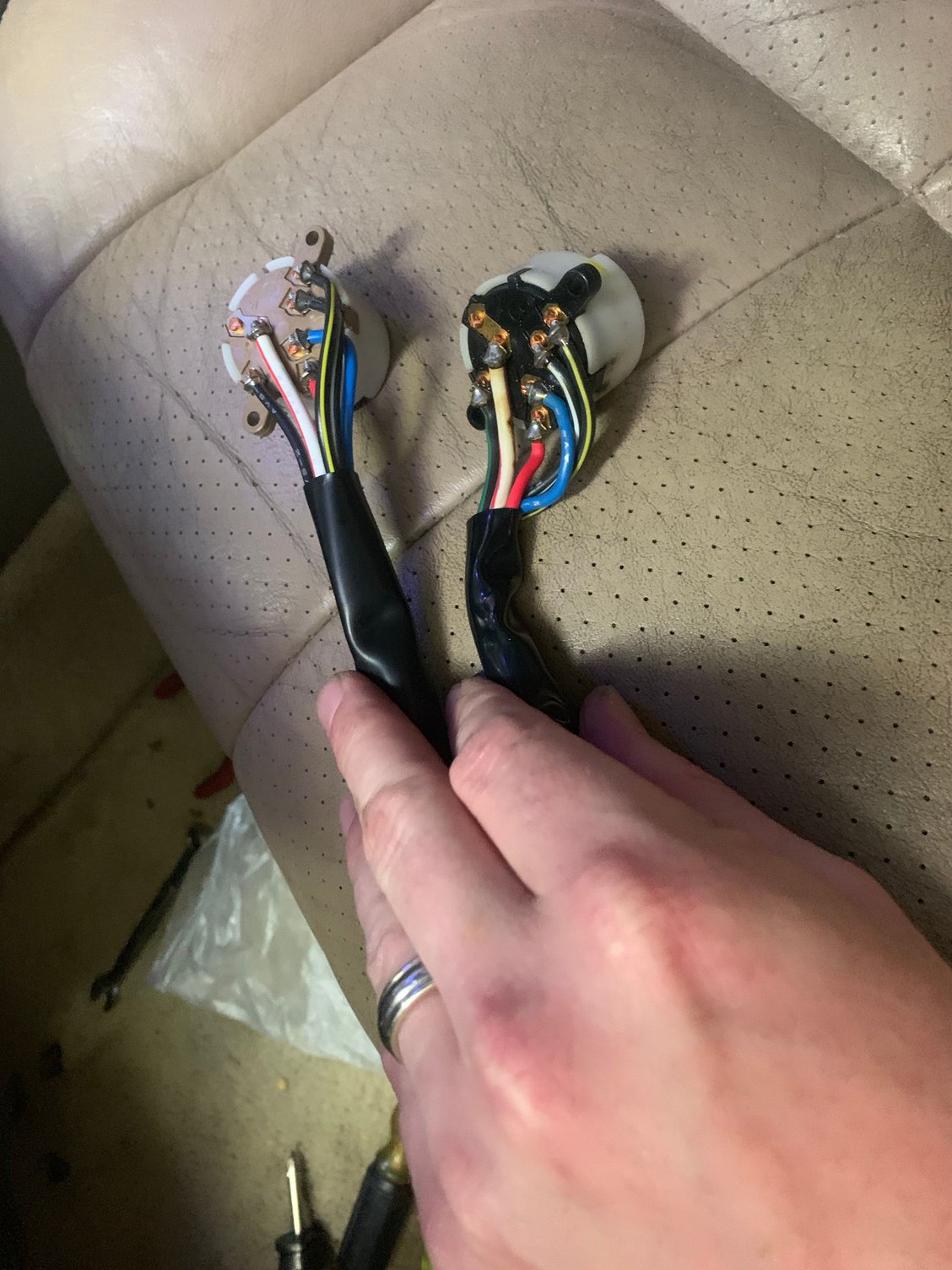

Side-by-side shot below that - the new one is _longer_, so there's just a little bit more cable to snug up inside the column cover when putting it back together.
This car has been running really well ever since I rebuilt the injectors - but it had seemed like just a very little bit doggy at idle, and even slightly more so in what we call "colder" weather down here. Not bad enough not to drive it.
After replacing this switch, however - wow much stronger and quicker starts, and much better throttle response - and I'm pretty sure I'm not making that up.
I wish I'd replaced this 20+ year old electrical switch when I first started with the alternator problems all that time ago.
