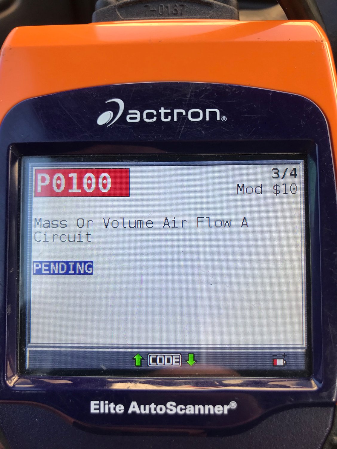

So I this car will not rev pas 3500rpm, and when it gets close that range, it sounds like there’s gravel in the engine lol. I had been getting codes for a bad MAF and crankshaft sensor (p0100 and p1335 respectively), so I bought both sensors, replaced them, and still the same issue. Used the scanner to clear the codes, but the light came back on about 5 secs after starting the engine. I’ve cleaned the egr tube and iacv recently in case anyone thought that might be the problem. I scanned the car again today and still the same MAF and Crank codes. I’m not sure at this point what the next step is.

Did you replace both crank sensors? Your scanner says that the REF circuit is the fault. Did you replace the REF or the POS sensor?

i cleaned the harness as best I could but my connector doesn’t click the way it should (unless the release is pressed in and then its inserted) and can be pulled loose easily. Could this be the issue? It seems like it’s reading the MAF though as when I unplug the maf harness the car sputters and almost dies.Originally Posted by Turbobink

Of course. The connector will have intermittent contact. If you hit a bump, or corner quickly, the electrical connection will come and go. Originally Posted by TonyStert

I’ll try to order a replacement. The only doubt I have is that when I did have the codes cleared, the car still didn’t rev properly. Also, the crank sensor clipped in fine with no hesitation, but that code will not clear as well. Are the two somehow related? It seems strange that both are having the same problem.Originally Posted by JvG

Did you replace these items with OE Nissan units?
If not, and if you've still got the original crank sensor, clean it up (including the connector plug-in) and reinstall it ... see if that makes any difference as far as the P1335 code goes.
Do the same for the MAF.
