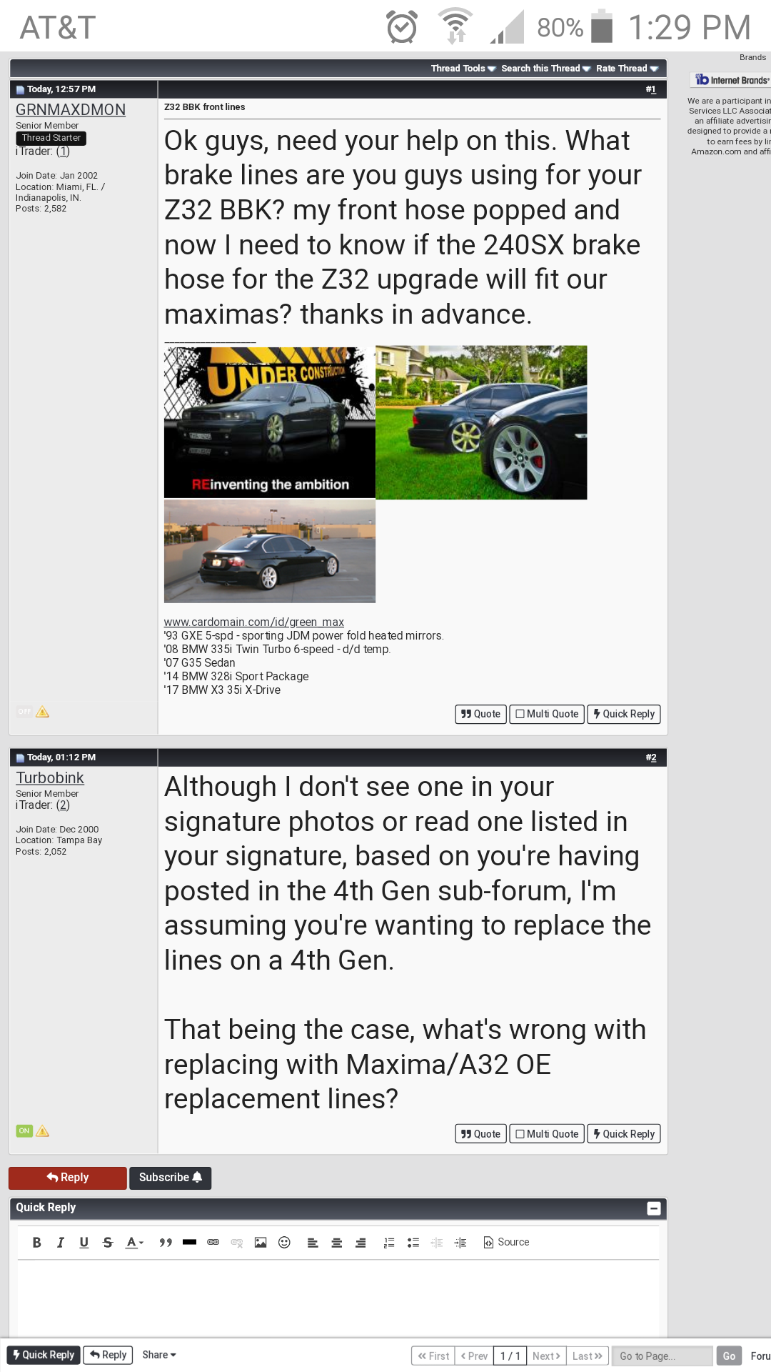

Ok guys, need your help on this. What brake lines are you guys using for your Z32 BBK? my front hose popped and now I need to know if the 240SX brake hose for the Z32 upgrade will fit our maximas? thanks in advance.

Although I don't see one in your signature photos or read one listed in your signature, based on you're having posted in the 4th Gen sub-forum, I'm assuming you're wanting to replace the lines on a 4th Gen.
That being the case, what's wrong with replacing with Maxima/A32 OE replacement lines?
