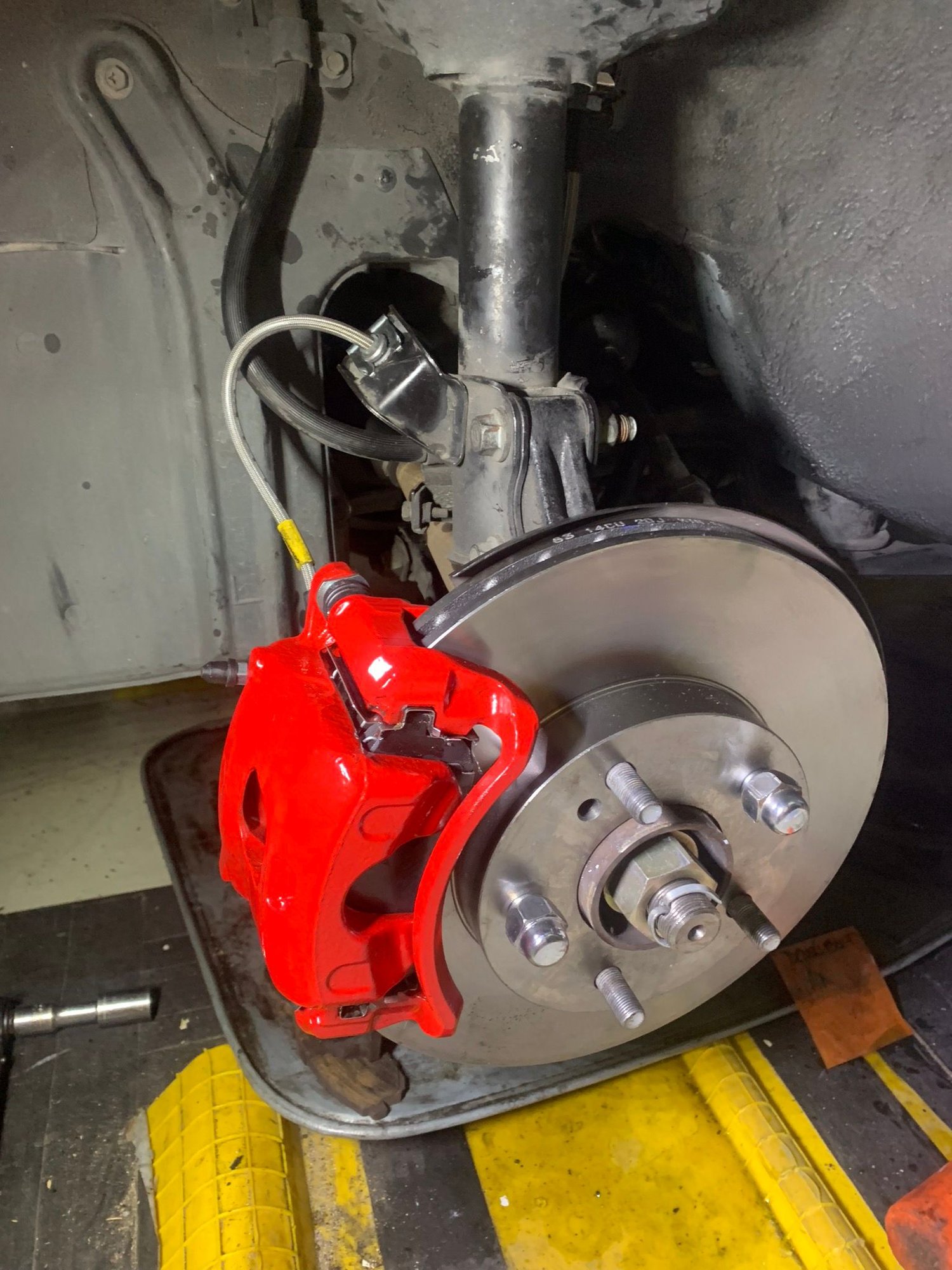

thanks. Am I supposed to lube or otherwise grease the hub before re-installing the new rotors? i realize the rotor is locked to the hub by the lug nuts, I'm just asking...
I wish I could see a better blown-up picture of what a fully-loaded caliper is supposed to look like (the pads are keyed inboard/outboard, including with the two pieces of hardware and the "leaf" spring, AS WELL AS ALL THE LUBE POINTS...there's a small Power Stop drawing on the included package of lube but its small and I'm not 100% sure what I'm supposed to be doing...
I am installing new Brembo rotors (09525410 front / 08806511 rear)
with Power Stop pads ( Z23540 front/ Z23450 rear) on new Power Stop calipers (S1218 front / S2000 rear) as well as Goodridge 22133 stainless brake lines. I think I will have extra parts left over a) because the calipers and the pads both included the same pad hardware and b) because the calipers included a single crush washer, whereas the brake lines included eight washers - four of which will not be used (only one crush washer at each end of the brake line, right?)
I guess I will start by FLUSHING the old fluid out of the OLD assembled calipers (using a hand-held vacuum pump/bleeder tool) - Drivers Front, Passenger's Front, Driver's Rear, Passenger's Rear.
Then I think I'll disassemble one of the calipers to see how it was put together - and then mock up a fully-loaded caliper, including hardware, pads, and line...once I figure out how to put that together 100% with the appropriate lube points I'll "simply disconnect the old brake line at the top of the wheel well and "reconnect the new fully loaded caliper in its place". Right?

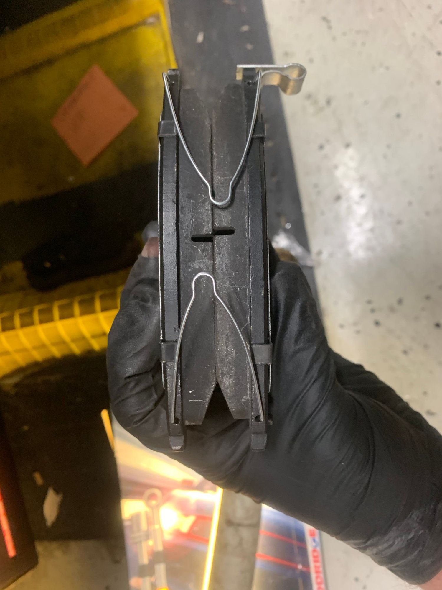

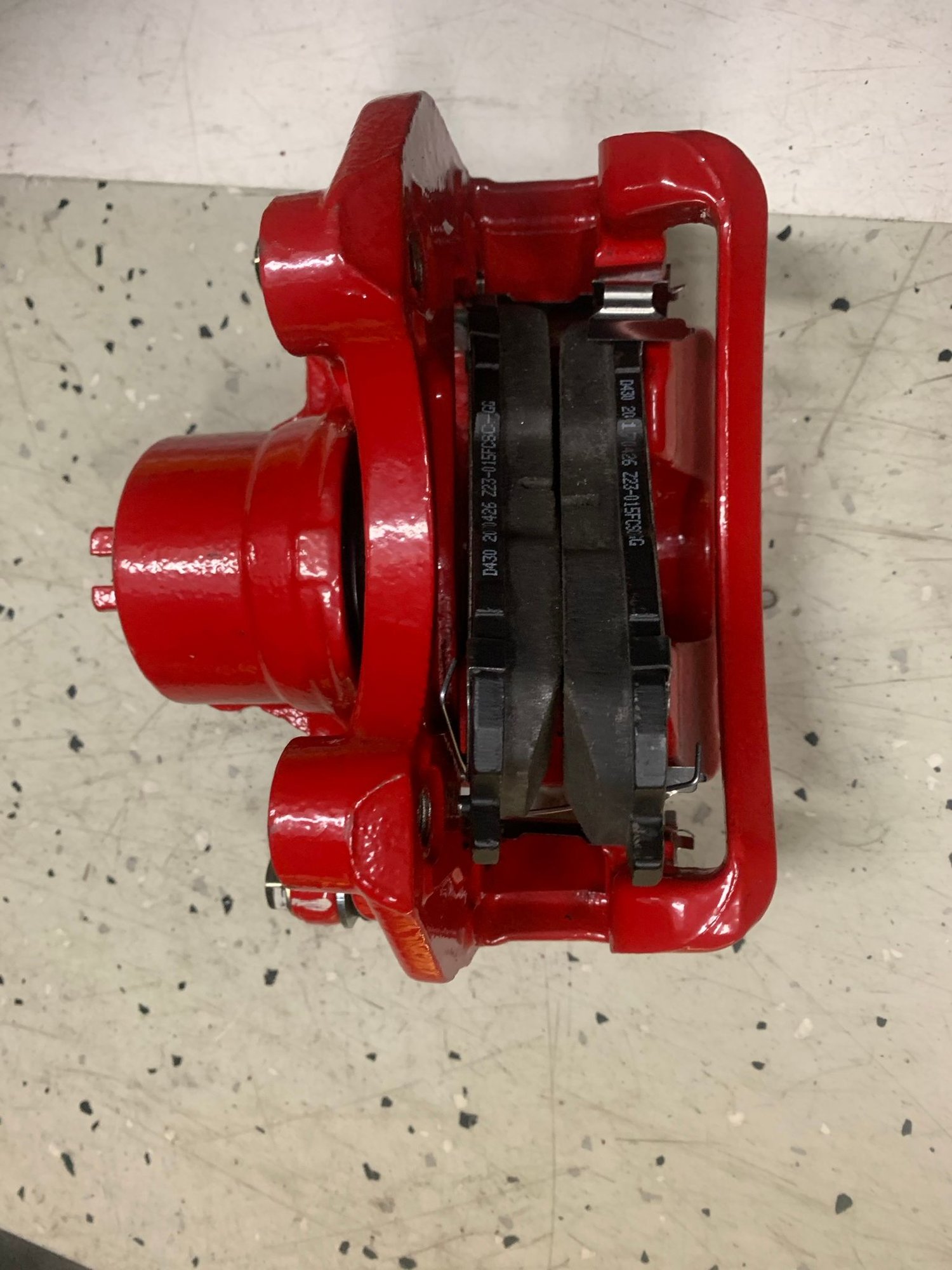

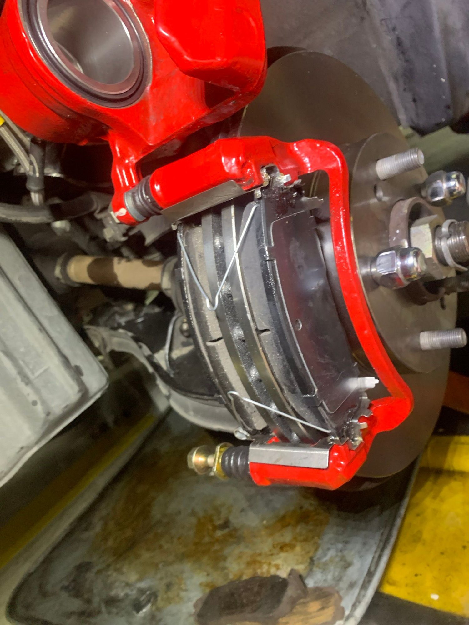

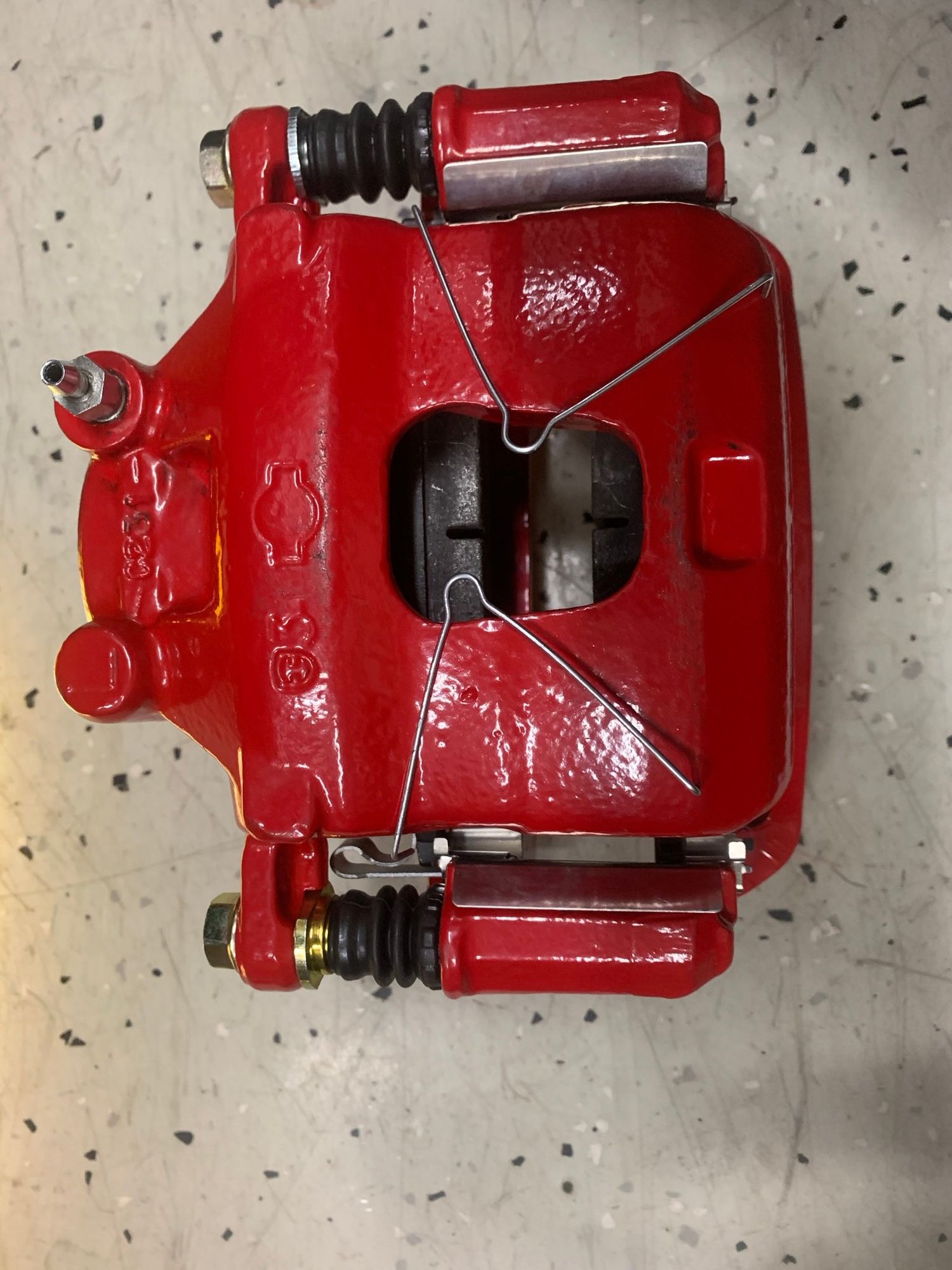

need front brake help please
I am having trouble installing the front pads into their calipers ALONG WITH THEIR RETURN SPRINGS. The return springs are v-shaped pieces that slip into holes in the pads, they ride above the circumference of the pad (at the top of, and inside, the caliper).
Is it necessary to DISASSEMBLE the two parts of the caliper in order to correctly install these springs ?
Or is it possible to install the pads with springs WITHOUT disassembling the calipers?
I surely got the old pads with springs out of the old caliper - but they have no meat on them, so there was a lot more space between the pads (where the rotor goes) than with this new hardware.
this is how the springs are supposed to ride - INSIDE the caliper of course
these are the springs installed on the pads
this is a half-*** attempt to install both pads with springs into the assembled caliper. the springs fall out of the pad holes (because it's upside down, right)

I think that those clips are there to keep the pads from falling out of the loaded caliper during shipment.
I've done brake pad replacements on many cars over the years. I have never installed loaded calipers. So I have never seen those clips.
I have rebuilt calipers before. The kits replace the rubber parts. The piston needs to be replaced occasionally. The rebuild kits never include those clips.
Please put the clips into the nearest trash can.

I made two calls to Powerstop. Then one of their more senior guys called me back, kind of on his own.
He described needing to take the two sides of the caliper apart (even though they're marked with paint re: factory installation). Mount the inside part to the knuckle, then the inside pads, then the rotor and then finally the outside pad/outer caliper (re-lubing the main pin before installation).
So my words now: essentially building the brake assembly like a cake from the inside out / "building a cake sideways".
That wasn't what I was planning on (I thought I would install a 100% loaded caliper onto the knuckle) but doing but it the other way may be the only way to make it all happen.
JvG - I see you say to throw the return springs away, and I also see other posts advising that other pad brands like Hawk don't even have the holes for the pad return springs.
For this job: the springs came with both the pads and the calipers - they're also shown in the FSM. I plan to use them if possible.
This is turning out to be harder than I expected but I'm in it to win it.

The clips are NOT "brake return springs"
they are only there to keep the pads from falling out during shipping. They serve no other function. They are meant to be discarded before sliding the brake disk between the two brake pads.
that's why I told you to toss them in the trash can.

I got this done.
I realize reading my posts above that I appear colossally un-informed. “It’s not possible to load a caliper without disassembling it (one pin bolt for fronts, both pin bolts for backs)” was what I needed to hear.
Yes, watching the YouTube helped. It’s a trivial matter to install the front pad return springs when the caliper is Open.
Also in my bleeding procedure above I got it 100% wrong: it’s supposed to be Passenger Rear, Driver’s Front, then Driver’s Rear, Passenger Front.
