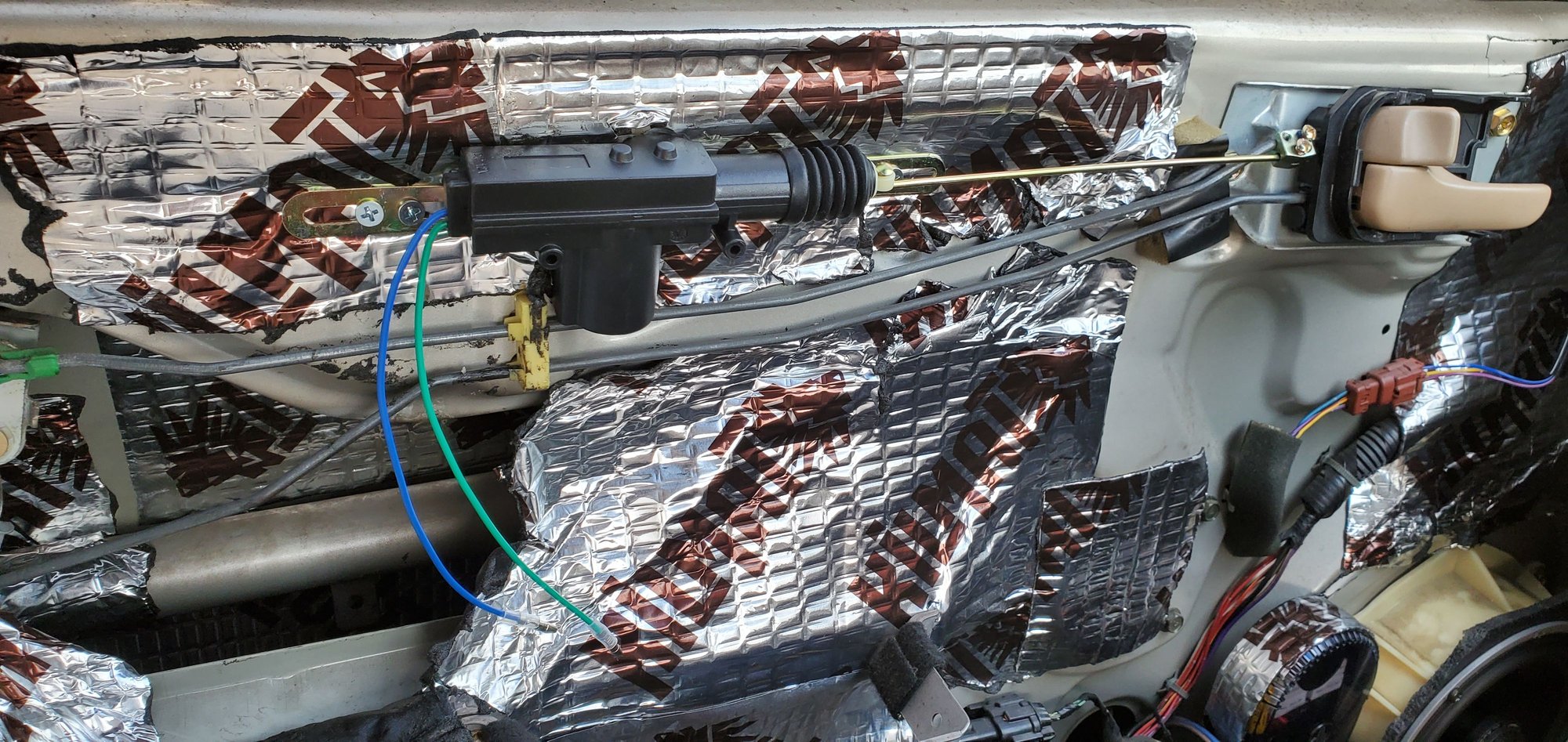

Once you have the panel off, you'll be looking at this (I removed the factory plastic moisture barrier):
2) The actuator is hidden behind the door frame. You can see its harness through the hole near the seat. I removed the harness by pushing a flathead screwdriver through the hole, to release the clip. Then I used a second screwdriver to pry the harness out while pressing on the clip with the 1st screwdriver. Once I had the harness out, I bolted the actuator into this spot. To get this to work, I had to break the mounting bracket that it came with. This is a great spot for the actuator, because you don't have to drill any new holes in the door frame. You can attach it to the existing bolts in a V orientation:
3) On the factory harness, the wires that you'll want to tap into are the brown / white and solid brown. Connect the brown/white to green, and the solid brown to the blue wire of your universal actuator. The blue wiretaps work great for this
4) Once the wires were tapped, I plugged the harness back into the OEM actuator. This was not even necessary, because the universal actuators are more than sufficient to push / pull the rods, but I insulated the taps with electrical tape and reconnected it anyway. Once your wiring is done, you'll need to connect the universal rod to the factory rod. I bent it into this shape, fed it through the actuator, and connected it to the factory rod with the supplied clamp and screws. **IMPORTANT** - before you bolt the new rod in, make sure that the orientation is correct - if the lock is OPEN, you want the new actuator to be EXTENDED. if the lock is closed, you want the actuator to be fully retracted. I added some blue Loctite to the clamp threads as well, in the event that the screws somehow loosen up over time.

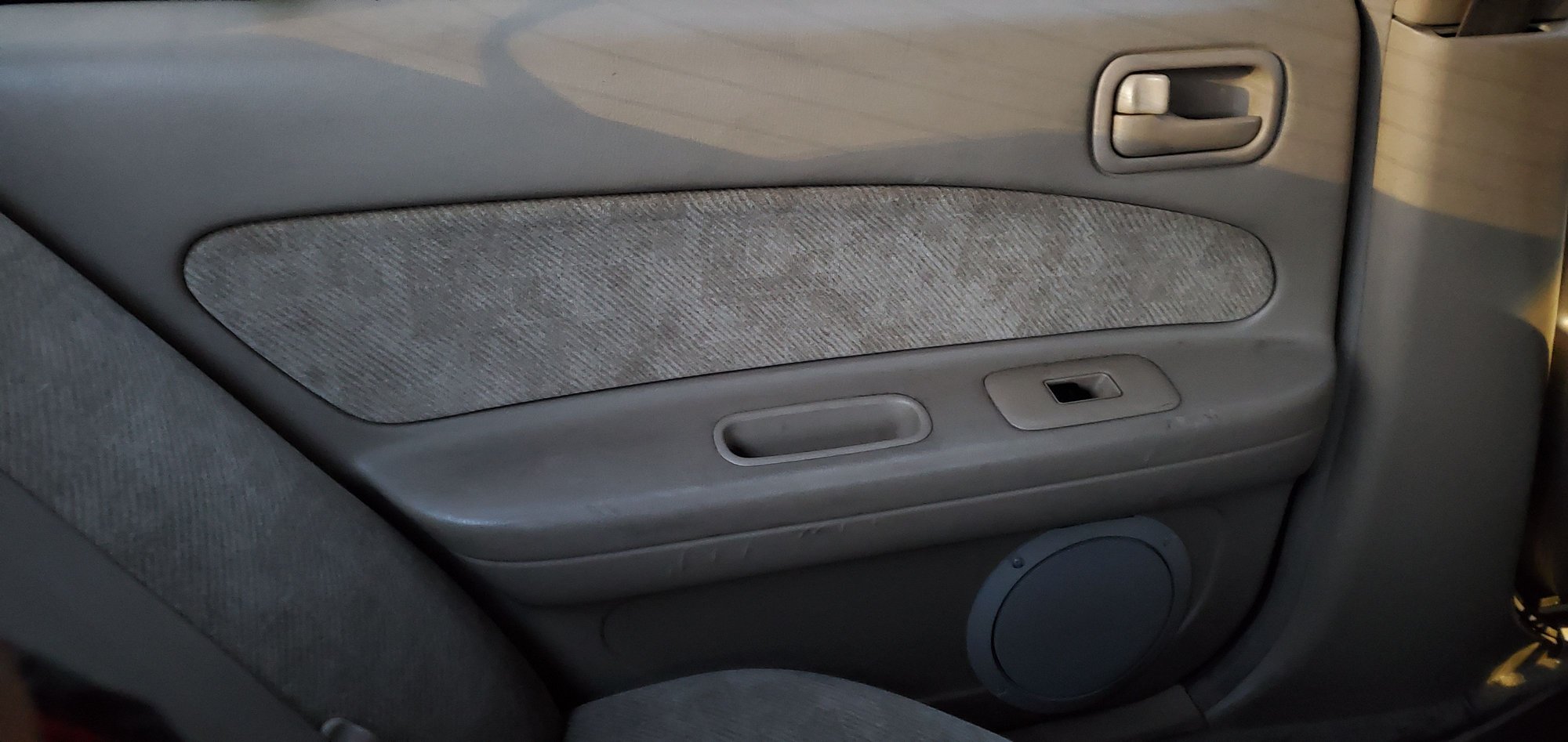

5 (optional) While I had the panel off, I decided to add some speakers to the rear doors, to give my audio some rear fill. I had some coaxials that I had taken out of my previous car, so I decided to throw them in. Slipped a 6.5" Boom Mat baffle into the hole there to create a tighter seal and also to protect the speaker. I cut out the rear of the baffle to allow for airflow. Bolted the speaker up, wired up the crossover, and fed the input wire out of the existing door grommet, and down through the B pillar into the car. adding the rear speakers made a HUGE difference in sound! The rear speaker doesn't interfere with the operation of the window either, since our windows only go down halfway anyway.
6) I re attached the door panel, after using a 6" hole saw to create an opening for the sound to come through. I covered it with a grille that I spray painted. The paint dried lighter than the representation on the cap, but I was more concerned about function over form... I didn't really care about putting a hole in the panel, because the panel was already in rough shape anyway...

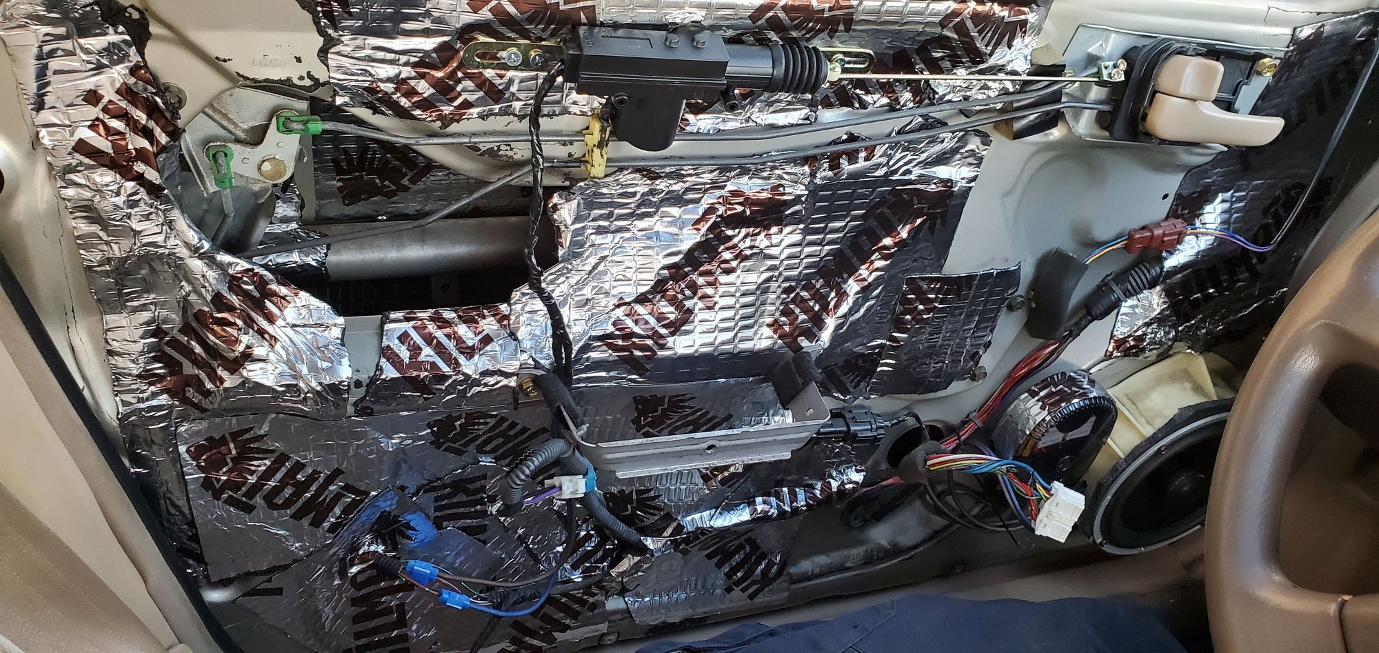

So that was the rear. Today, I completed the front. Similar process. Here is what I did for the driver's side:
1) Remove the front door panel (thanks again pmohr)
2) I chose this spot to mount the actuator. Before I screwed it in, I made sure that the panel would clip on properly without being obstructed by the actuator. It did, so there it went. Be sure to measure the new rod before you bolt it in place, because I had to clip off about 2 to 3" of it for this application. Once I had the correct length, I fed the rod through the actuator, pushed the rod through the clamp, and then I snapped the clamp onto the factory rod. Applied some loctite and screwed it down. Of course, I managed to lose one of the screws. There are supposed to be two screws securing the new clamp to the factory rod, and one screw securing the clamp to the new rod. It held fine with one screw, so I proceeded.
3) I already had some sound dampening material on my front doors, so I had to peel some of it back to access the wiring harness for the front actuator. It runs along the bottom of the door. I pulled it inside of my kilmat, and stripped away some of the plastic conduit to expose the wires. Same deal here as the rear, you want the brown / white and solid brown wires. Since the new actuator is at the top, and the wiring is at the bottom, I had to extend the wires. I crimped on some 14ga cable, wrapped it up, and ran it down to the factory harness. Used the blue wire taps again, wiring done!
4) Tested the new actuator, works perfectly! The lock snaps open and closed as if it were brand new. Video attached:
5) Wrapped everything up with tape, put some kilmat over the new actuator to help protect it (probably not necessary, but didn't hurt anything).
6) Once I confirmed everything was working correctly, I put the door panel back on. It snapped right back into place. No resistance or snags of any kind.

You are correct, the harness that plugs into the factory actuators has four wires, while the universal actuators only have two. This is the only harness that you need to work with. I used my multimeter while pressing the master lock / unlock switch to determine that the wires that energize the actuators are the brown and brown/white wires. On my harness, these two wires were thicker than the other two - your harnesses should look the same as mine. When I plugged my multimeter into the brown / brown/white wires, I hit the master lock / unlock button and saw a brief -12v / +12v readout on my multimeter, confirming that these were the wires that I needed to use.
Connecting the green wire of the universal actuator to the brown/white stripe wire, and the blue wire to the solid brown wire yielded correct operation of the universal actuator; pressing the lock switch caused the actuator to retract, and pressing unlock caused it to extend. Be advised - when you are testing your new actuators, you have to reconnect the window switch for the side that you are working on, or hitting the master lock / unlock button will not send any power to the actuators. I thought my actuators were duds at first until I realized this!
For the rear doors, after I spliced the new actuators in, I reconnected the factory harness to the OEM actuators. I figured I would keep my Oem actuators connected in the event that one of my universal ones failed (at $13 for a set of four, I didn't know what to expect). In doing so, my new actuators are essentially working as boosters for the original ones. I have not had any ill effects so far, and everything is still working perfectly! I did not even have to unplug the OEM harness when doing the front, because the wires run along the bottom of the door and you have a good amount of slack there to work and install the wiretaps. So I left it connected, peeled open some of the OEM black plastic covering to expose the wires, and again tapped into the brown / brown/white wires. Note my picture for the front door, you will need to extend the wires on the universal actuators to reach the bottom of the door, so that you can tap into the brown / brown/white wires. To do so, I just used some regular 14 gauge wire (16 gauge will probably be better, the 14ga was a little thick for the crimp connections). I stripped back some of the insulation, plugged it into the crimp connections of the universal actuators, clamped it down with the pliers, slipped the clear insulator over the connection and then secured it again with electrical tape. I was then able to take the other end of the extended wire and use the blue wiretaps to connect it to the brown / brown/white wires down below.
When you are clamping down the blue wire taps, i used a small set of locking pliers to do so. I opened up the plastic tab, and used the pliers to squeeze the metal tab down. Once the connection was tight I snapped the plastic cover over the tab and wrapped the entire connection with electrical tape. I remember the first time I used wire taps, I snapped the plastic cover on first and then clamped it down with pliers. I finished the stereo install to find that nothing worked. I thought that the wire taps were junk, but I then realized that I was doing it incorrectly. I had no connection because the metal tab did not go down far enough to tap into the wire. Man was that frustrating!
