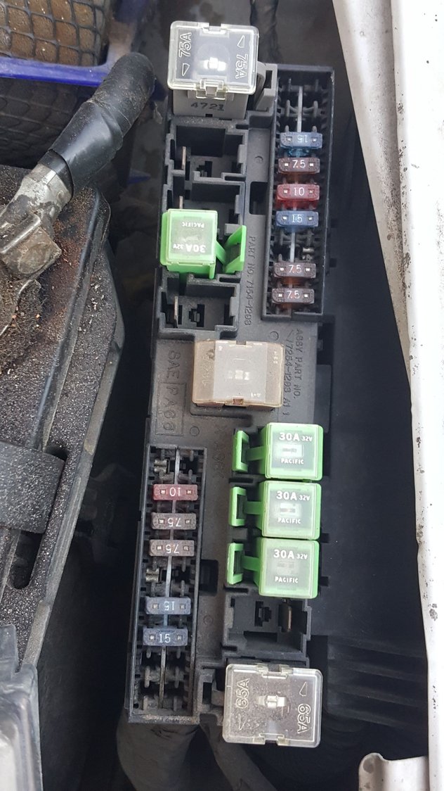

I am having a problem with Cruise Control.
Is there a fuse or relay for the cruise control?

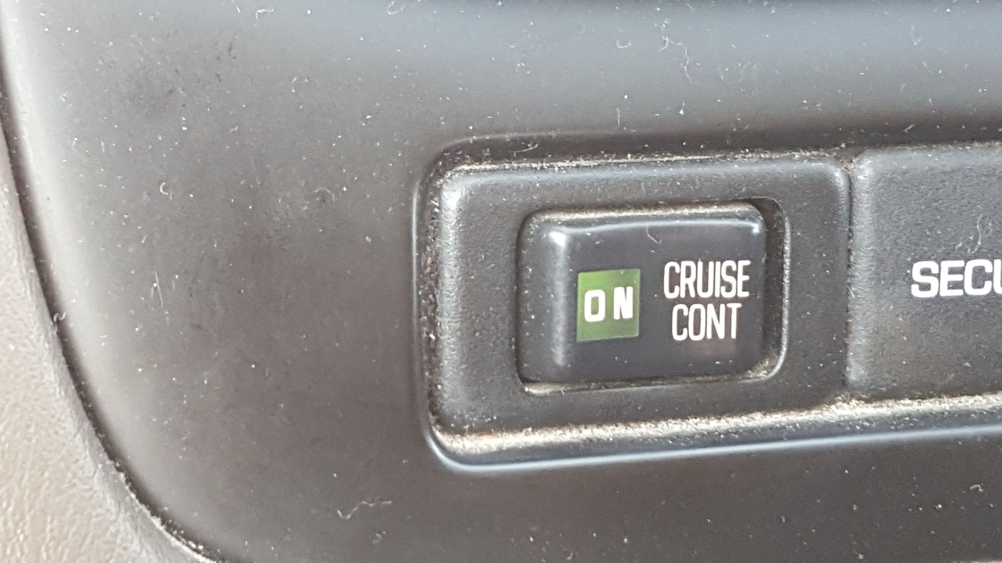

pump motor works. Hose replaced. Cruise On/Off switch turns on green fine.
It just doesn't engage. Not the switch on brake pedal (penny glued on it already just in case).

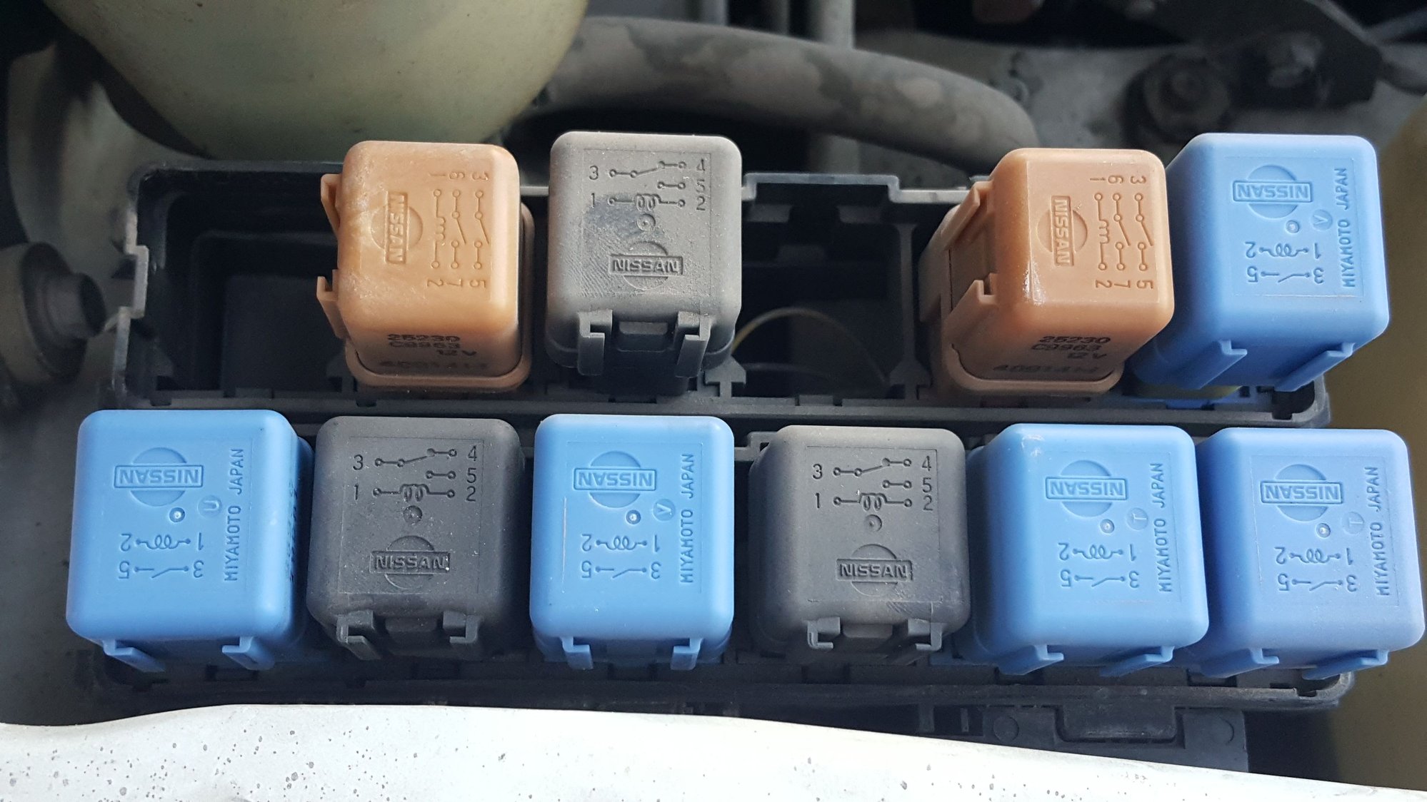

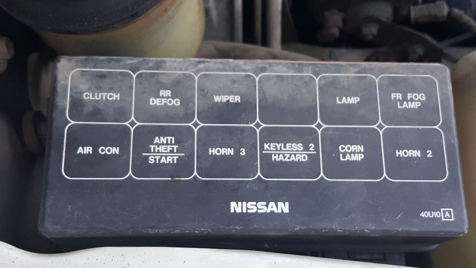

None of the relays shows for Cruise Control or ASCD on the covers.
What are the 3 relays on the left of the fuse panel?
Is there more of fuse or relay box that I have to find?
Please help.
Thank you,
Switch turn on fine
What are those 3 relays on left of the fuse panels?

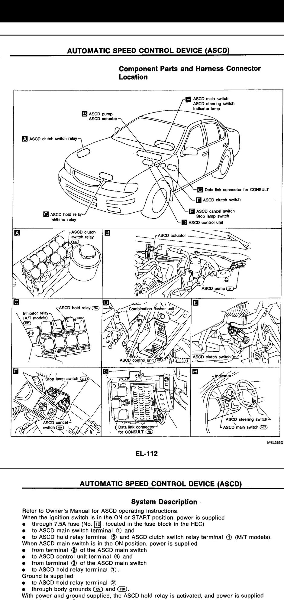

crap... How did I miss the relay box C?
I will check that thing out today.
