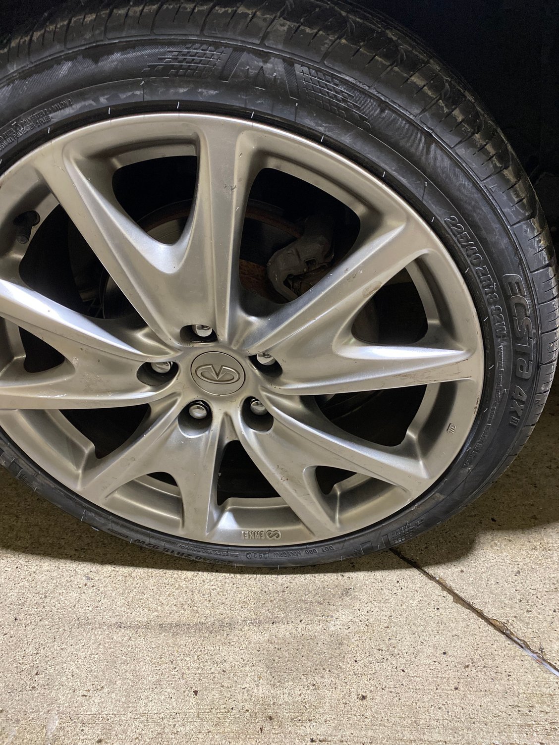

Any got these on a fourth GEN? Found these with like brand new tires for $400 thinking about putting them on my Beater.
New to the forum did a search couldn’t really find any pics of these just another version of G 37’s

Gonna be some soon... so I bought them

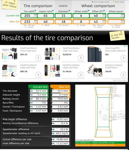

Profiles for 8 inch wheel
I think this size should work the best

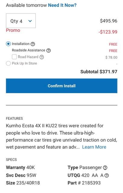

Fairly good deal on ecsta

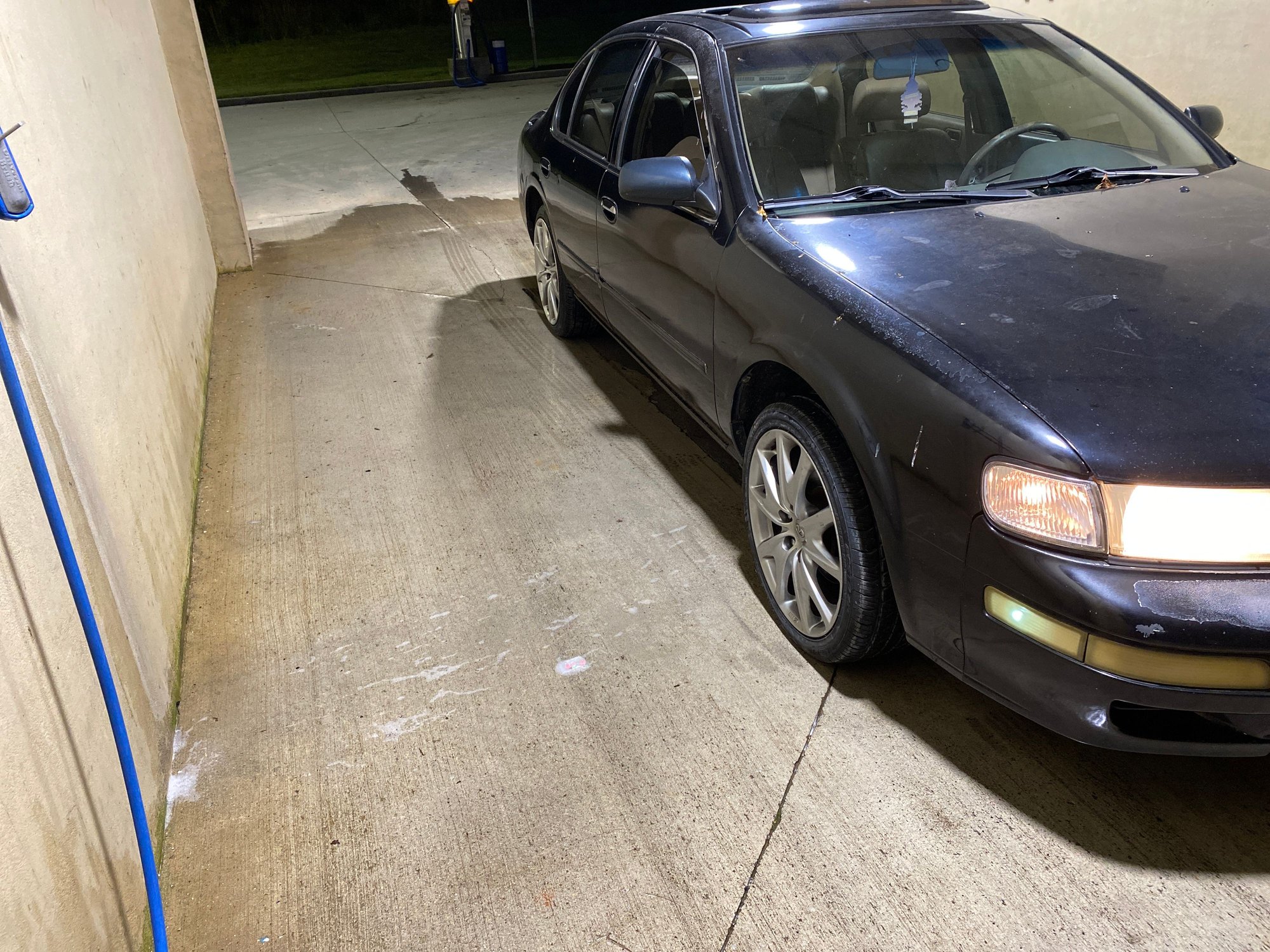

They are on
Went with some 225/40R18 kumho The rear wheels are staggered so they’re stretched a bit not sure if I really like that or not gonna let it sit there for a little while I may end up going up to 245’s in the back. thinking about dropping it not sure if I’m gonna go coil overs or not.Struts and springs are kind of wore out it’s not a horrible ride but not great either. Think I’ll drop it before I decide to change the Rear tires.

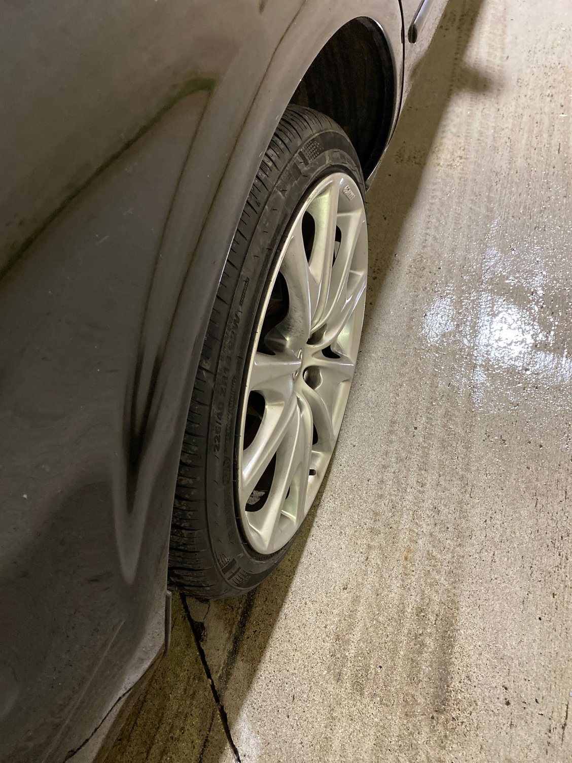

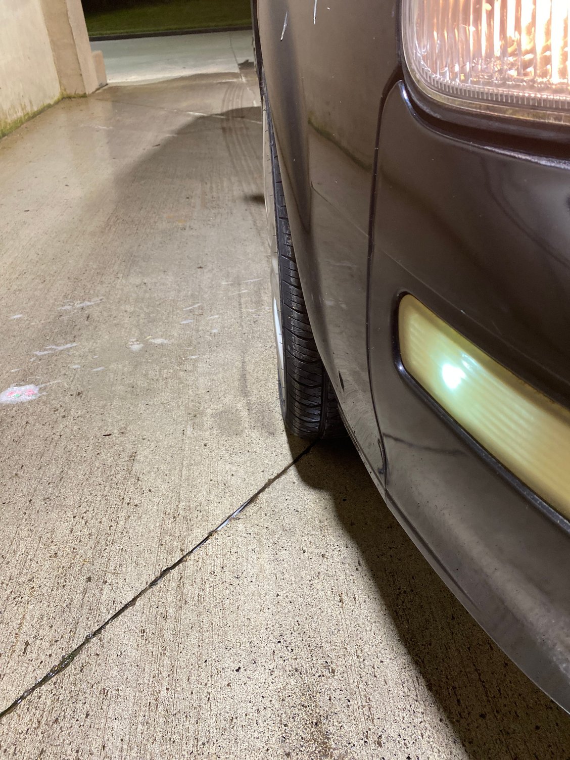

i was really worried about clearance, and I actually could of went larger. Once on I checked clearance and had a fat thumbs worth fully turned.

when I started this thread this was the input I was searching for... was worried about fitment so stayed conservative

Only thing I really noticed is that the rear wheels need some spacer to really fill out the wheel well the front fit perfectly with an 8 inch wheel. Those are some sweet headlights man

I have 20mm spacers on the rear. Makes the rear offset look equal to the front.

So do you have to get like lug extensions to be able to make that work
Old Oct 14, 2020 | 04:41 AM
RA030726's Avatar
I'm nutty for Nissans
Posts: 9,311
No, you can get bolt on spacers. Make sure you get hubcentric.
