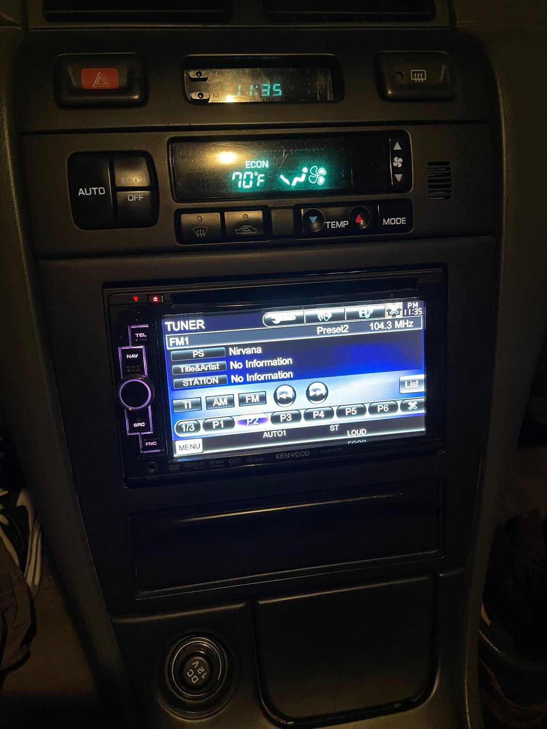

Exactly. Crutchfield sells the Bose amp interface which is pretty much the reverse harness with a little box on it. Works like a dream with my kenwood head unit. I think it was around $50. Not sure if I needed the antenna cable adapter too but that wasn’t much more.
Didn’t touch my original Bose speakers/ amps at all.

Check my previous post. I am running a kenwood head unit with all stock Bose speakers and amps. I didn’t touch anything. Crutchfield sells something called a “Bose amp interface” that takes care of all the compatibility issues. It plugs into the stock harness behind the head unit just as a reverse harness would then you just splice that into the harness of your aftermarket unit. Crutchfield has fantastic customer service as well, on the phone they can walk you through everything you may need or if you have any issues.

DNX5160
I’ve had it about 10 years and installed it in my last two cars.
To my knowledge the interface takes care of everything and is plug and play. Worked for me and sounds great.

OK 98 and The Wiz,
You win! If the amps and speakers are still strong, I will use this in between! Let's hope so! $260 is enough. Speakers and maybe amps will bust the bank!
Years ago, almost 40. Had a Ford van I bought an Alpine Head Model 7347 (Top of the line with DBX for the cassette) A Nakamichi amp @ 75 real watts per channel and pristine clean. Then a pair of Infinity 6X9s 3 way with emit tweeters. $1200 in 1983/4 dollars. OUCH!
Everybody that heard it was blown away! Talk about a measuring stick?
I want to go BACK!
Old Mar 5, 2022 | 02:14 PM
KP11520's Avatar
Joined: May 2012
Posts: 1,622
From: Long Island
Tested an old cassette I had around. Just people talking in a forum (town water discussion) Not high fidelity. But no static when talking, which there is way too much of with the FM.
So there might be hope for the amps and speakers. I will have to find a HiFi cassette and see how real music sounds first. But there's hope!
Now either a used 99 Bose Head or mine repaired by Mike's suggestion, or that Kenwood HU above with the adapter from Crutchfield.
Just keepin you that are interested in the loop!
