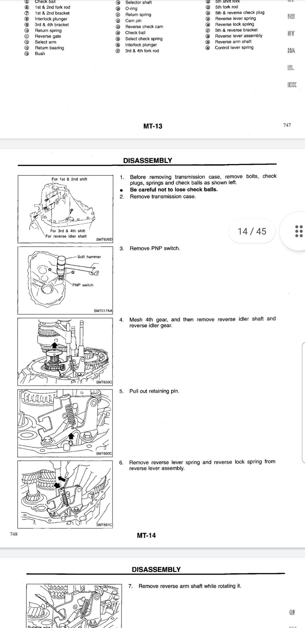

Hey mark. Double check that it's not the reverse retaining pin. Step #5

Also would be sure to check that you got the smaller interlock plunger in. Screwed me over before. Step #8

Thanks for the help but its not any of the plungers, they are all accounted for. And this pin is about 2-3 times smaller then said plungers and steel *****.
Sorry to say It's not the reverse retaining pin either that is already installed.
Thanks for the picture though.

Even the plunger that goes through the shift rod? That one is not the same size as the other *****.

Yes it was the small plunger that goes through the shift rod
THANKS A TON!!!
No clue how I missed that. Your a life saver!
Thanks for all the help everybody.
