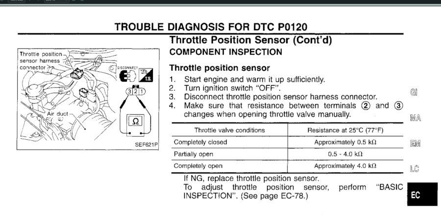

Today I tested my TPS with the multimeter and got 0.8 closed and 4.5 open (I guess kOhms). It was 0C outside today and the FSM guideline is for 25C. I would think that the resistance should have gone down in colder temperature, but I don't know. Am I out of spec?
Driving The Big Hill today didn't seem slow this time... but maybe last time I was loaded down with 200lbs of cargo. Downshifting into 2nd going down felt interesting, definitely easier on the brakes. Dunno if the fiddliness is worth it for a hill this length though.
