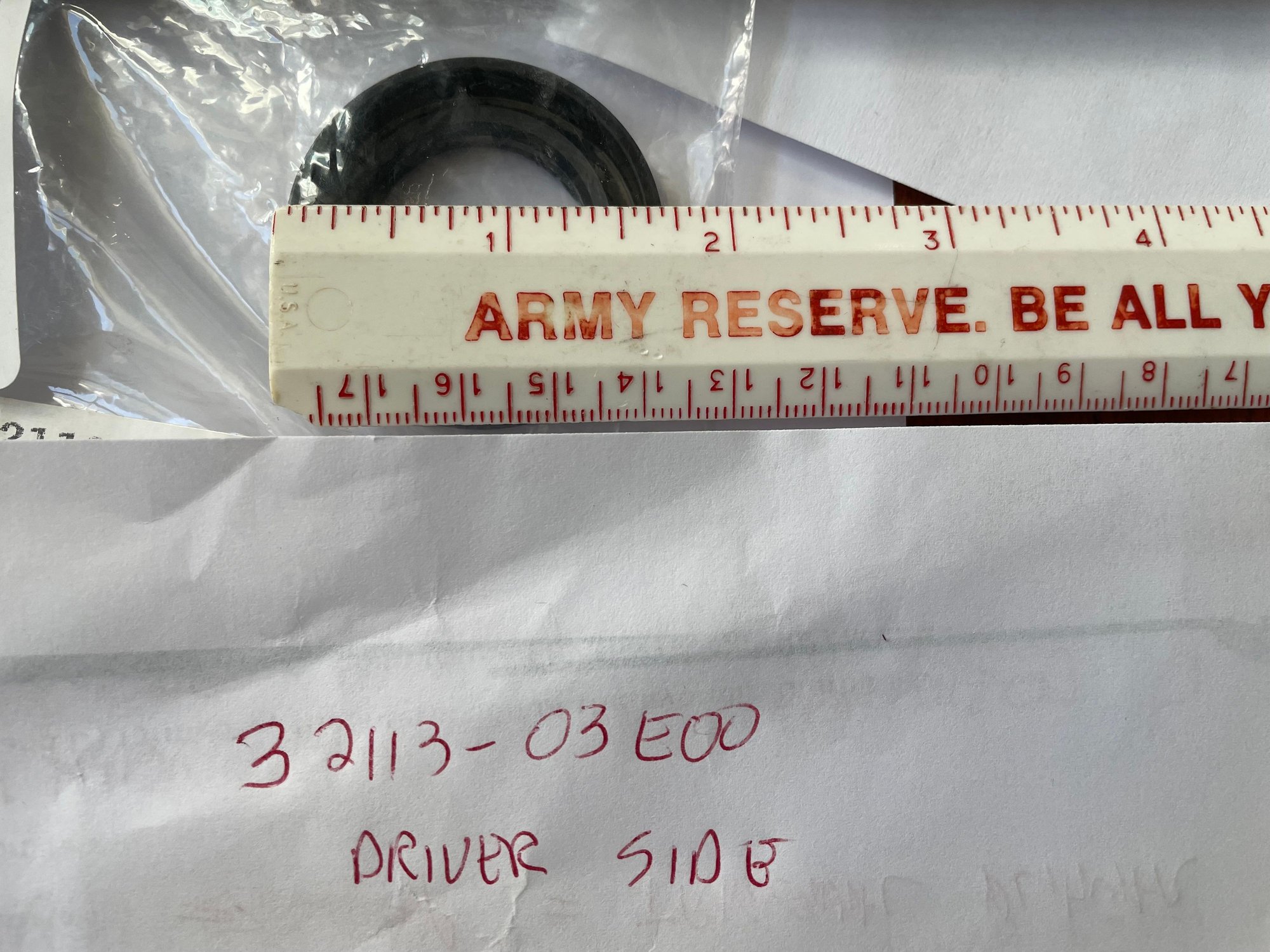

Thanks. So that is a 2" outer diameter pipe? I notice the driver and passenger side seals are different diameters. Looks like the passenger side is about 2 1/8" outer diameter. and driver is 1 1/2" I assume the pipe is for setting the passenger side seal then?

As far as installing an oil seal, you want to drive it into its "hole" as evenly as possible, hence using something like a piece of pipe that is ideally the same diameter as the seal. You don't want the seal driver to be smaller than the seal as this could possibly bend the seal into a concave shape. You want the force pressing on the outside edge of the seal, not the flat center portion. The seal goes into the differential housing with the flat surface facing out and you only drive it into housing until the oil seal is flush with the differential housing.

The OD is the same for both seals. 2" iron pipe is what you need.
Limited slip have one bigger seal, it's 90mm or about 3.5".

Thank you. The driver side seal I got from Nissan has an OD just over 1 5/8". I looked up the part on nissanpartsdeal and it does appear to be the right seal. Won't the 2" OD pipe be too large?
