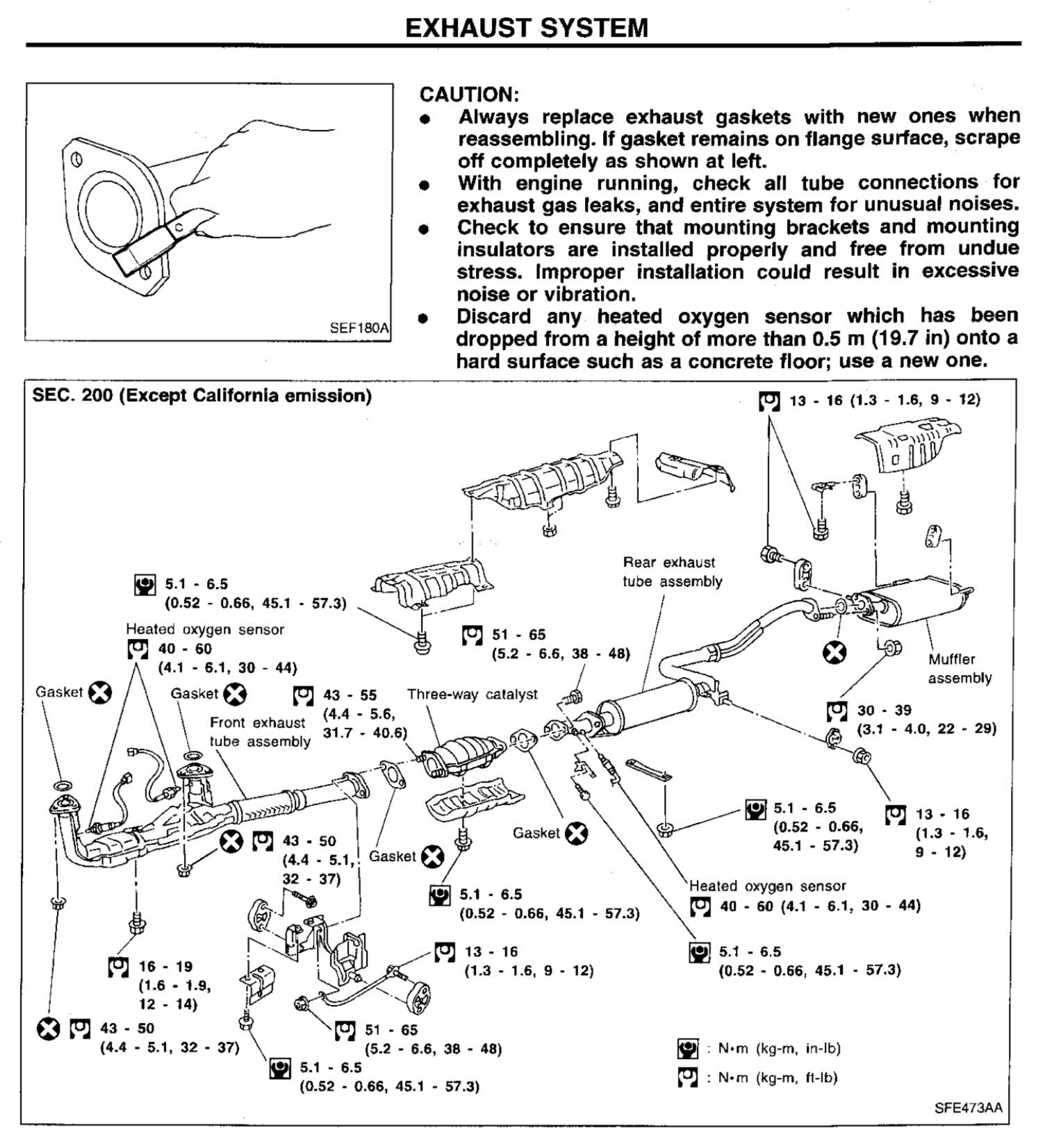

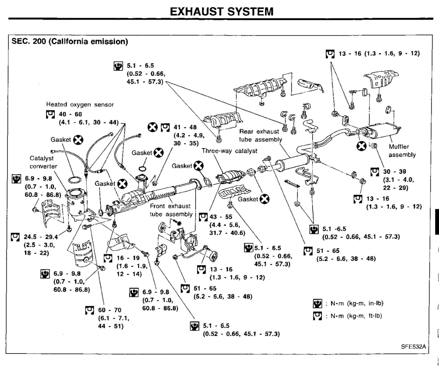

Here’s both the California Spec and the Fed Spec systems (1999 M.Y.) from the FSM.
Note the locations of the system segment pieces and connections and the rubber ‘suspenders’.
The pieces that Keith linked you to sounds like what’s likely gone bad.

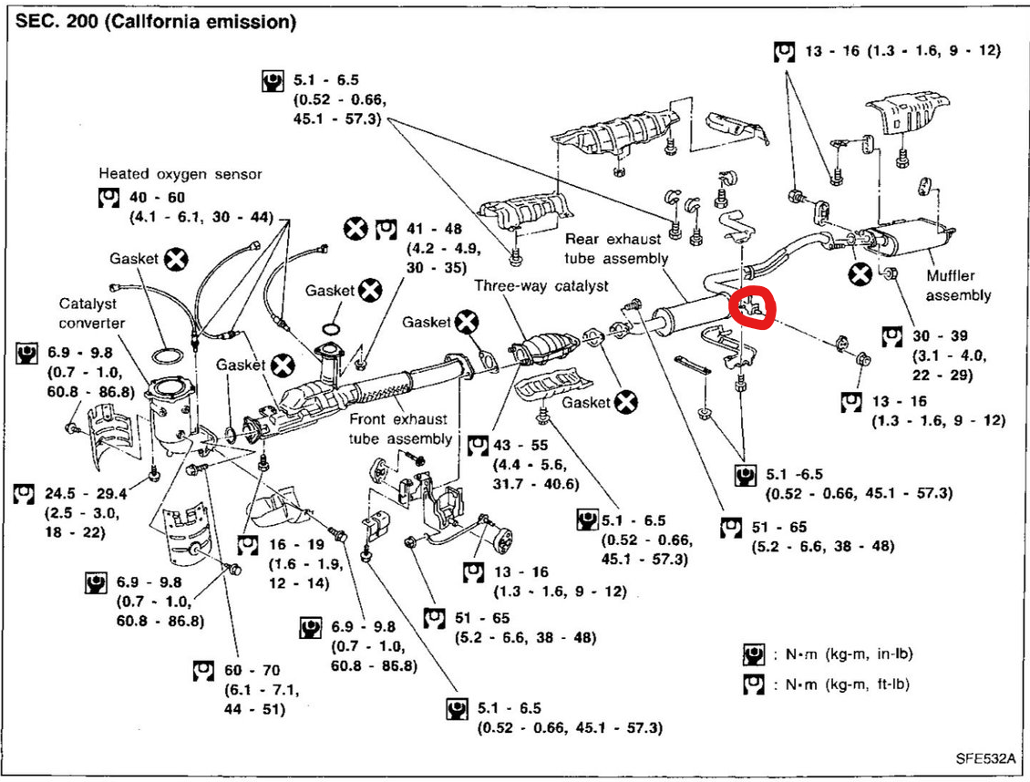

@Turbobink @KP11520 Thank you for the info and graphics. I now know what they are called.
I looked underneath the car and it looks like there is a bracket that is broken or rusted off right after the rear exhaust tube assembly. A rubber hanger/insulator attaches to it. So that hanger is not working to hold up the exhaust at that point, instead it is still being held by the 3 rubber hangers on the muffler, plus 2 rubber hangers right after the front exhaust tube assembly.
This is the part that is broken:
My question is, is it ok to keep driving without that one rubber hanger not functional, and just leave the system hanging by the other 5 hangers?
I wasn't able to figure out how the bracket broke off... if it rusted off or what... it is still attached the to rubber hanger and just dangles there. I dunno if there is a way to fix it, or if its even worth fixing. The 5 functional hangers are still in ok shape. My original concern was the whole exhaust was too loose because I heard a rattling noise when going over bumps, but turns out the rattling was just caused by that broken bracket that dangles from the rubber insulator.
