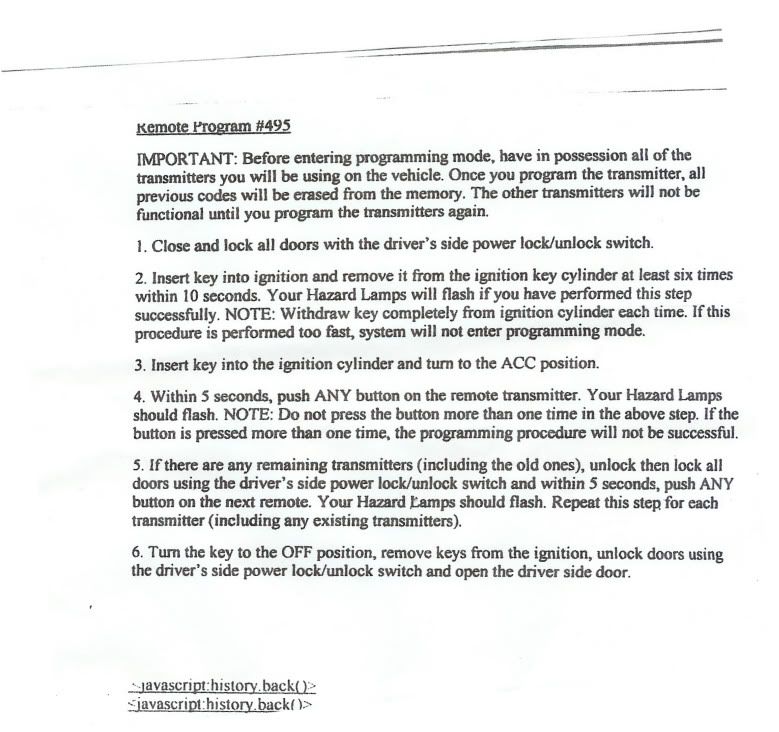

Old Aug 27, 2006 | 01:37 PM
H8tank's Avatar
Joined: Aug 2006
Posts: 13
Thanks for the intructions, they are pretty much the same as I have found and tried, I follow them to a 'T', but I cannot get the flashers to show I have entered programming mode as stated in Step 2. I have tried all speeds, the only thing I have succesfully done is manage to make the old fob inoperable like the new one.
Any ideas? Car is basically stock, except for aftermarket Pioneer deck and Steering wheel audio button controller.
