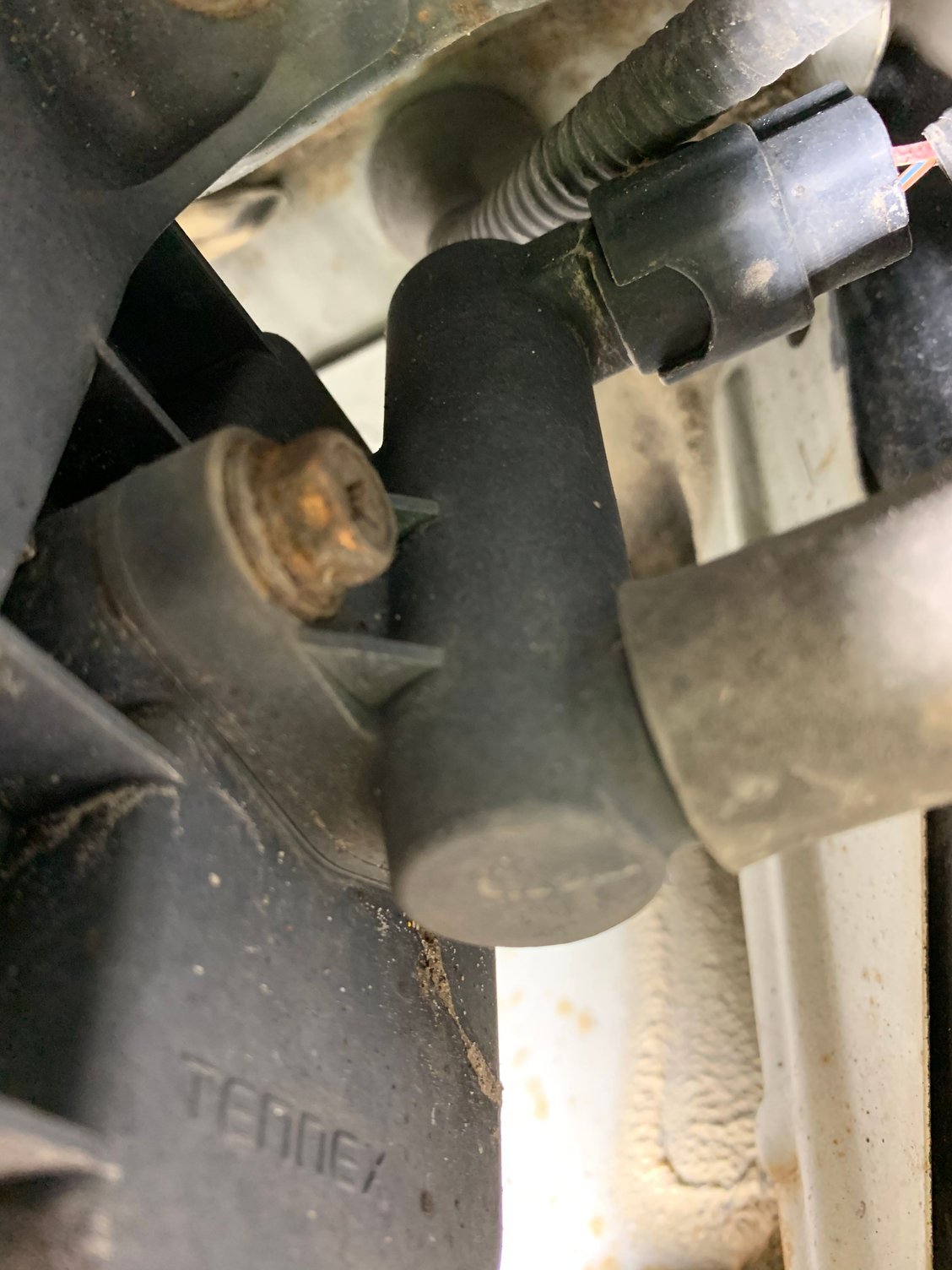

I also want to
replace my evap canister vent control valve for my 2003 maxima. My part looks like this.
I cannot find this part online. Vendors say the part will fit my car, yet their part contains no place to put the bolts.
What they sold me and I am returning
I may have to abandon this project.

maybe not the right part, but the parts are out there, i just did that one in 2018.

Originally Posted by reggut
I also want to
This part?
Amazon Amazon
https://www.rockauto.com/en/catalog/...solenoid,16992
