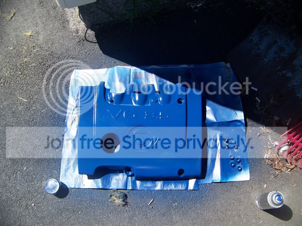

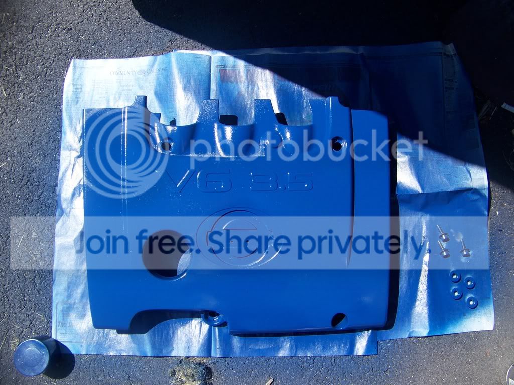

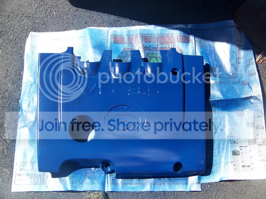

Start painting per the instructions on the can. First two coats light folowed by a medium wet third coat. With 10 minute wait inbetween coats.
First Coat
Second
Final
Now would be the time to clear if you chose just be sure to get all three coats of paint and clear on within an hour(per instructions).

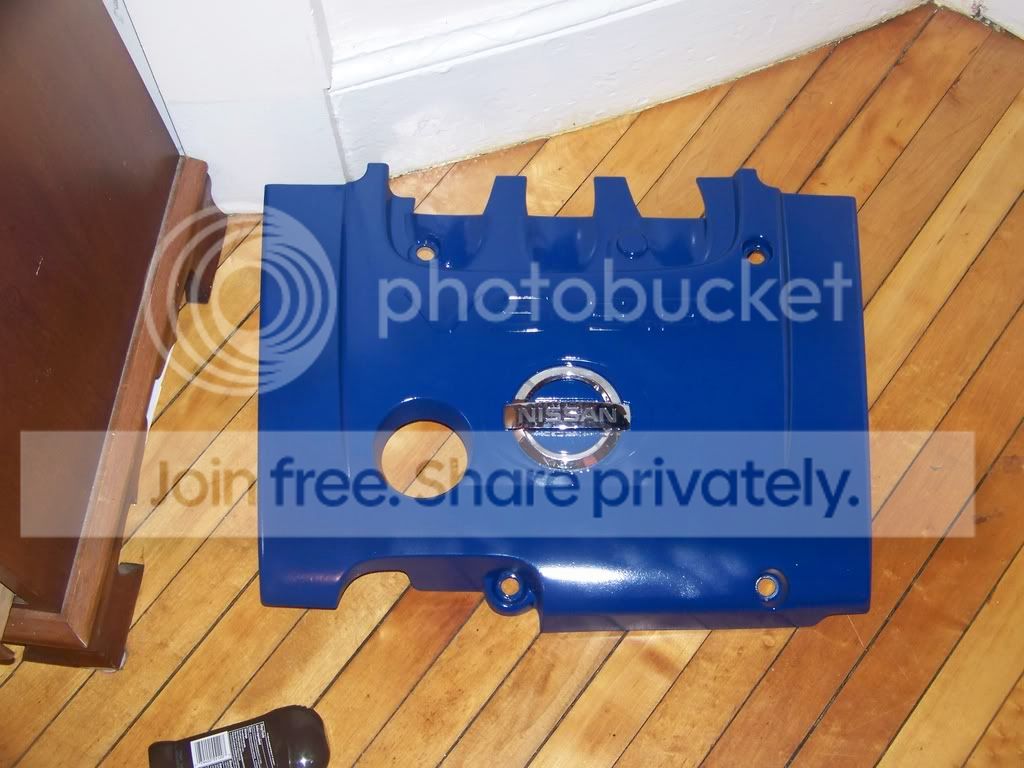

And thats it just give it at least 3 hours to cure before putting the logo back on as it may damage the still soft paint. I just finished paint and plan on putting it back on the car in the morning to give it enough time to cure. If further coats are needed wait 7 days for full cure(per instructions). And that's it now you have a nicely painted cover. Just rember take your time and do it right the first time as it would probably be difficult to fix if not done correctly. And the final product...
Not the best pic it looks like there are inperfections but its just the lighting it came out real smooth. I'll post a new pic when it's back on the car.
