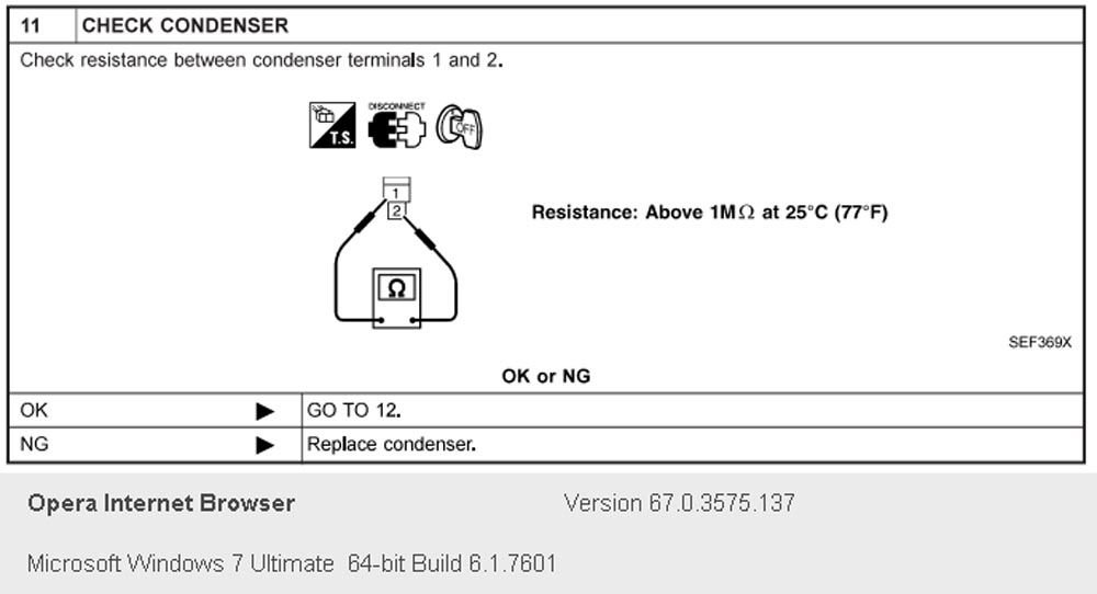

Hey All;
After relentless determination i followed everyones advice...and I finally FOUND THE CONDENSER on my 2000 infiniti i30 >>>
I was taped around the harness...as per FSM...i cut it out and it was fried beyond belief (OHM READING was 0.00-OL)) ..
CONDensor plug signal and ground continuirty good _
Luckily i di not have to pull the ECM out...was fine backprobing with t-pins )) pinout good so far..next is to put in a NEW CONdENSOR
im posting pic....if it helps anyone locate the condenser....
thanks again..i will post an update soon )))

2000 inf i30 condenser location
HOPE THIS HELPS >>> took a few days to find it..it was right in my face..hidden..taped up..its tiny...-SO LOOK FOR a square deformatiy behind the wire harness against the fuel rail )) FSM = Factory Service Manual...
According to the FSM OHMS reading should be Above 1 MEG OHM or above
