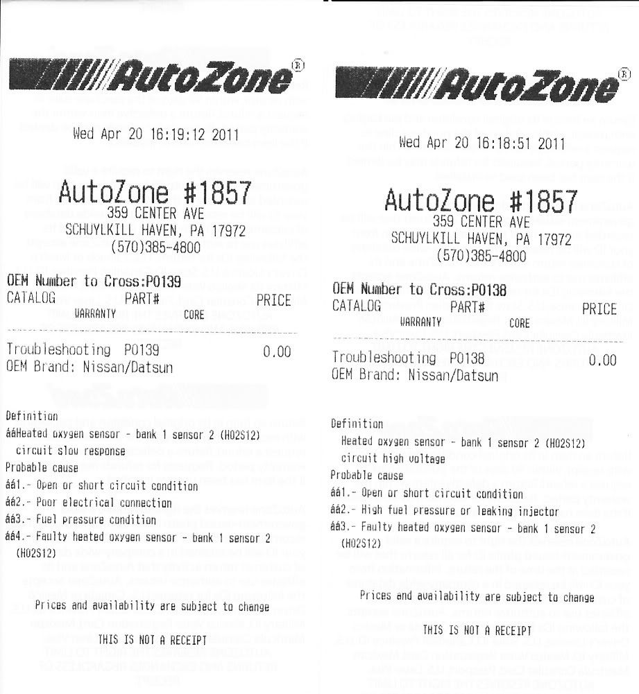

Originally Posted by NmexMAX
SES?
Could be a CPS.
Only a O2 sensor code.
Only Codes I got.
I forgot to mention I smell heavy fuel vapors that have a odd smell not like raw fuel before i can get it started. then it chugs like it has a huge cam them smooths out and idles fine.
