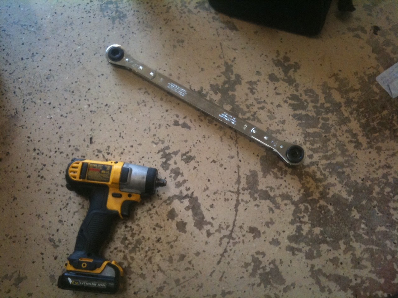

Finally got it! I used a serpentine belt tool to loosen the idler pulley, once lossen the tension adjuster nut STILL wouldn't turn. So, I hit the nut with my 1/2" Impact Wrench, thinking if it was broken I would have to replace it anyways, and i broke it loose!
So I was able to get it changed, guess we'll see if I can get the tension right.
Below is a picture of the serpentine tool I was talking about. Its not one of those cheap sets you can get at Harbor Freight - It's like a gear wrench with 4 different sized sockets.
Old Nov 25, 2011 | 01:31 PM
jgilbs's Avatar
Joined: Jun 2010
Posts: 251
Pictured is the 3/8" Impact, it took a MUCH bigger impact to get that nut loose
