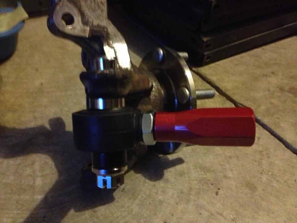

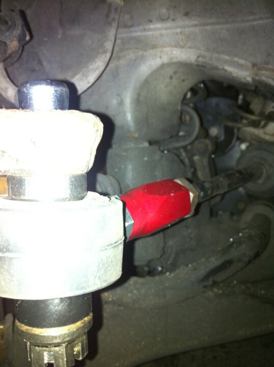

Can u please post a pic of the correct way to install TDMI Bump Steer Kit. The oem outer tie rod goes on top of the spindle. The TDMI Bump Steer Kit goes under the spindle as the correct way according to TDMI pics. My mechanic installed the bump steer kit. After installation the car has excessive camber issues. Its unstable plus the steering wheel doesn't come back to the neutral position. Please help. Thanks
Old Apr 20, 2014 | 11:30 AM
  #1061
SAK74's Avatar
Posts: 180
From: NEW YORK
Plus my bump steer kit is blue. Every other pic I see they are red. Thanks

I would reach out to TDM on the color, not sure about that.
This is the correct way to install (pics stolen from clintb3astwood's thread):
It should definitely be installed UNDER the knuckle. This is to aleviate the severe angle on the tie rod end when aggressively lowered.

Those are the pix i was referring to. Thanks.
That is exactly what I thought.
& That is exactly what how my mechanic installed it.
Maybe because im not aggressively lowered im mildly lowered. Hmmm

I think the real question is if the mechanic understands the reason and usage of these. My bet is "no." He likely just installed them based on standard protocol, not being educated on what these are and their purpose.
If you're mildly lowered - then chances are you can get away from normal ITR's. But if with the mild drop you're still experiencing serious bump steer, then you need these.
And if so, they should be installed in the fashion they were designed.

My bump steer kit is blue & it doesn't have that bolt next to the red part as in the pic. It's one solid piece. Is the red one adjustable where the bolt is cause mine isn't.
