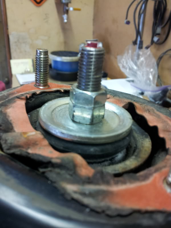

Hey man - Exactly what I thought. I'm not a fan of the doubled approach. I reuse the OEM nut. It has a nylon washer so it helps to keep it tight, plus its flanged whereas the ones that come with the Illuminas are not.
We tried that but it appears as if the thread pitch is not the same.. Finer pitch on the OEM.
The instructions I have call for only hand tightening of that middle nut...

Are you certain?
This is the first time I've EVER heard that the thread pitch on the Illumina is different than OEM. And I've probably installed a few hundred Illuminas. Also I usually go tighter than 'hand tightening' on that middle nut.
Don't worry about the gasket. No harm if you don't have it.

Ok we went more than hand tight...now gotta bend that damn brake line bracket thing for the front to get her to fit, other than that we're good

Also,.had a clunk in the front, found that middle bolt not tight enough...tightened to spec now all is good
