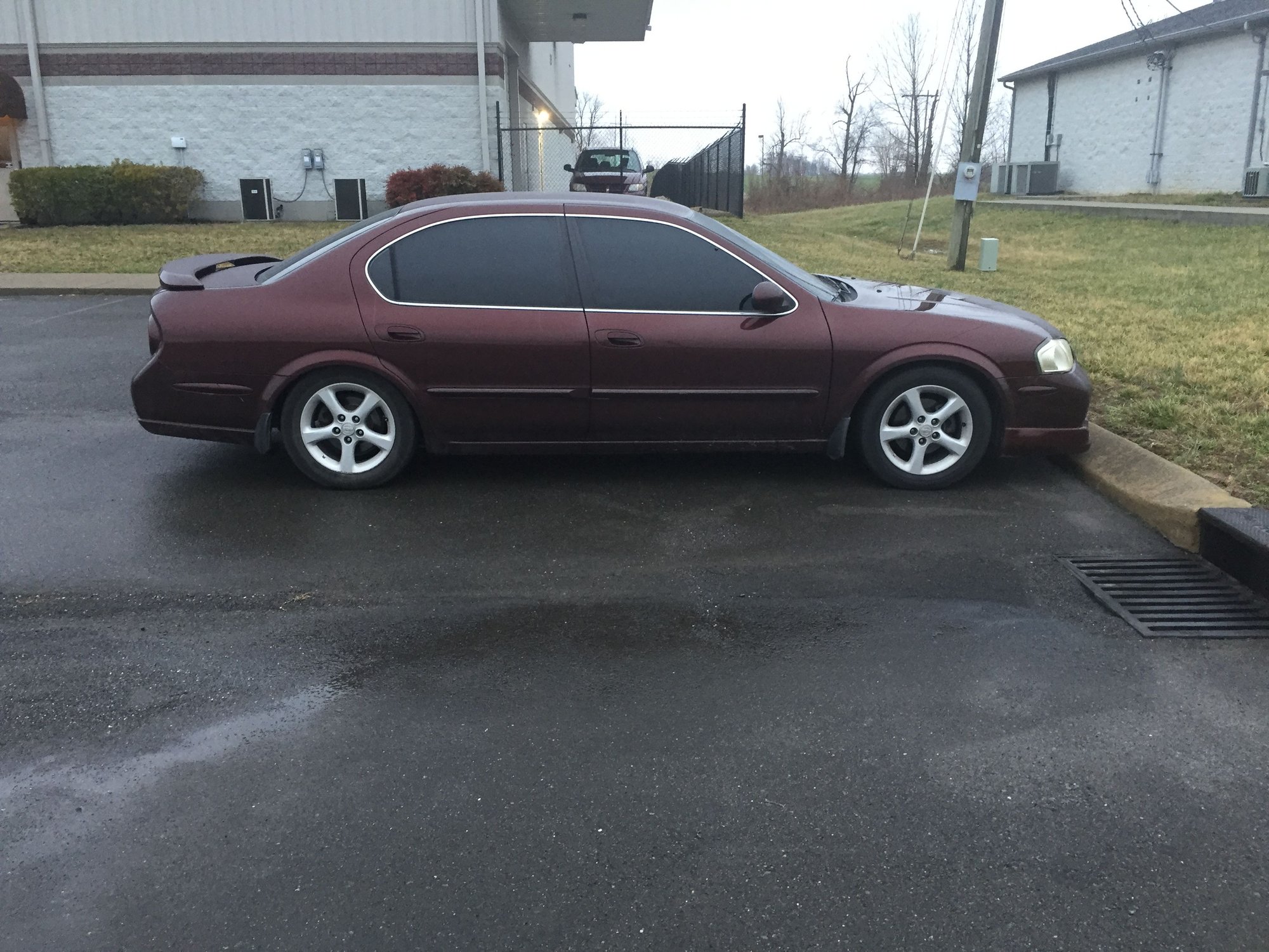

OK guys, I have a dilemma.
Bought my 02 SE about 6 years ago lowered. The ride has always been rough. Not sure if it has lowered springs or running stock (how do you tell?), I just know I have Tokico HP Blue's
Now, I love the stance but the ride quality is TERRIBLE. I feel every bump, crack. My right rear strut is needing replaced so I obviously have to replace both in the rear.I have been battling with getting standard Monroe Quick Struts but don't want to sacrifice my ride height. Any suggestions?

If you are lowered, then you're not on OEM springs. Visually check the springs and look for markings, branding, and color of the spring - this will give you an indication on the type of springs you have installed.
Tokico Blues are not meant to be used in lowered applications - hence the poor ride quality. Since you enjoy the ride height, I recommend you replace the struts.
Before I recommend a strut that is appropriate, I first need to know what springs you are running. Let us know and we'll go from there.

I checked. The springs are red, no visible markings or brandings I could see. I will wipe them off and try to see if there is a marking anywhere. EDIT: Wiped them off, still no visible markings/branding.

Bright red or pale red? Off color or true red? Orange maybe?
What is the height from floor to fender in front vs back?

I would say a pale red, more of a redish burgundy. Unfortunately I have no tape measure, to measure the height. I know I suck with the details sorry!

Slammed on these cars chew through cv boots and axles
Only fix raise it

your right. i ran through literally everything but a rack and pinion
I do love the way it sits but i just wish it was a comfy ride.

Let us know when you have the height. I'll use that info to suggest a strut.
I'm no pro with measuring tape but I believe I measured .8" from the floor to front bumper lip and 1ft from the bumper bottom in the rear
Need measurements of floor to middle of fender please. At front and rear. Driver vs passenger doesn't matter. Not bumper measurements.
