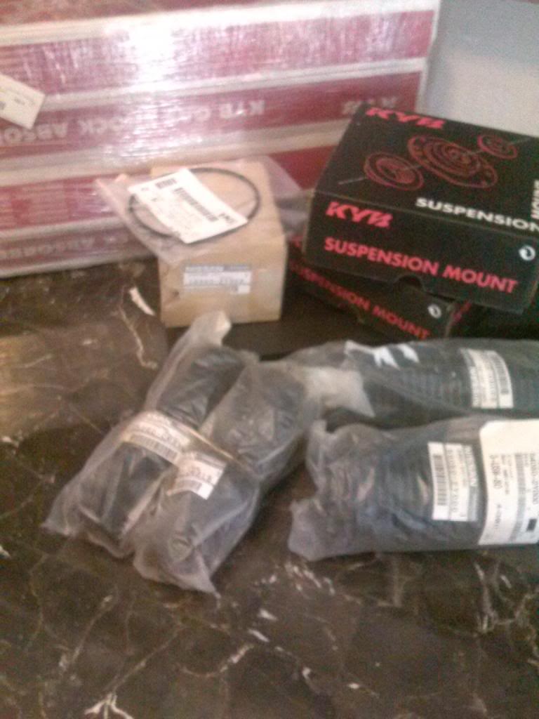

Size:  73.6 KB Happy 27th birthday to me and her!when the fronts get here I'll be ready for install hopefully Friday
