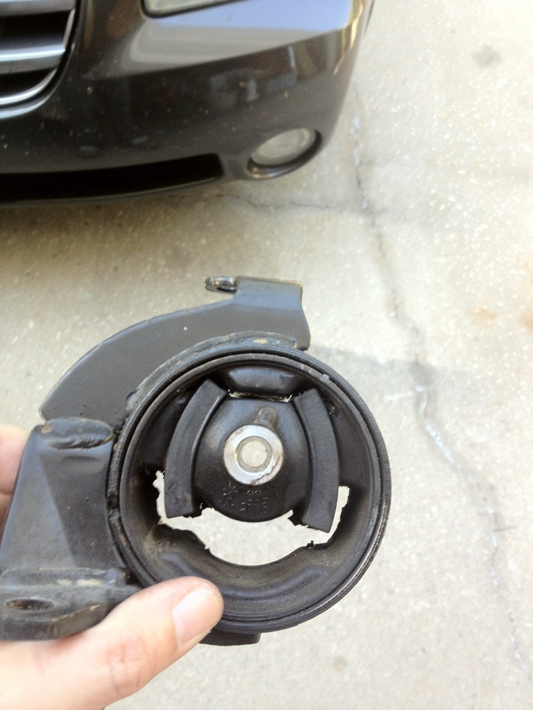

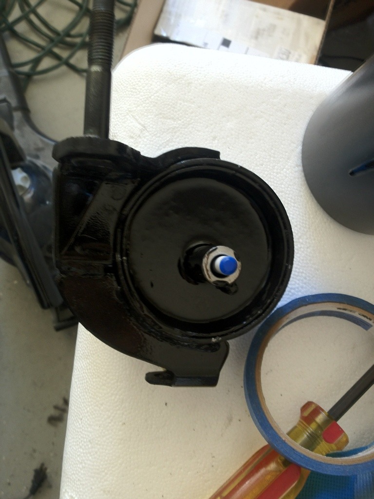

also built him a better engine mount to improve shifting and not have to use those engine torque dampers.
before
and after
before
and after

What's the mount made out of?
