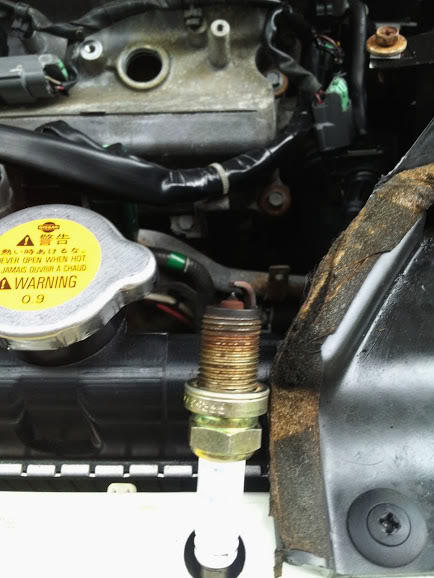

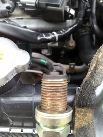

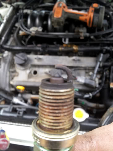

i have 948xx miles, the coils are the original w/o the grey dot. so i replaced the plugs just because.. with the NGK step below the oem plug just to test, the coils seem fine no codes , when I unplug one it throws the code and can feel the miss in the engine.. found a nice set on Ebay that I might pick up just because.. I think i will replace the o2 sensor in in the manifold closest to the firewall since I pulled a code for lean bank1, I wanted to think it was associated to the MAF , it never came back but I need to get my car inspected ASAP.
