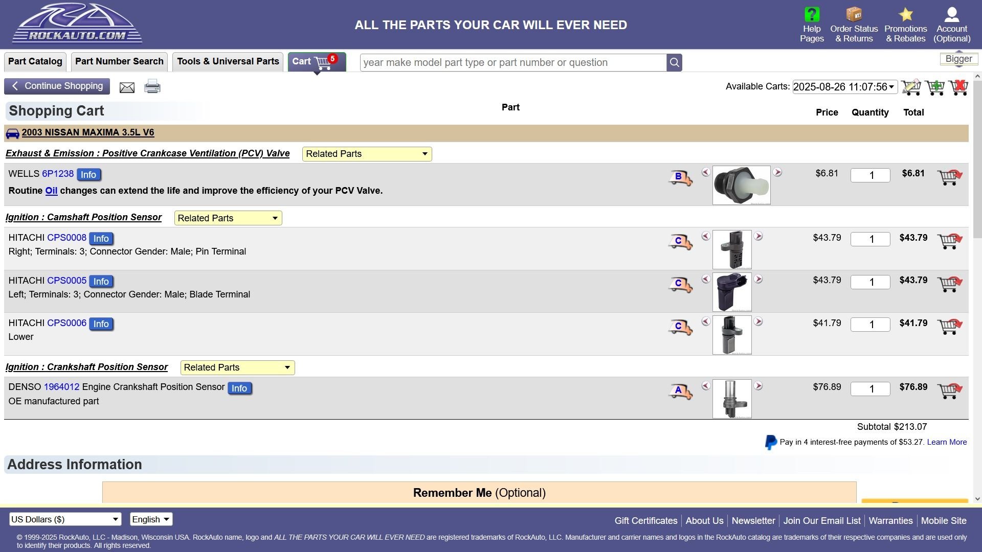

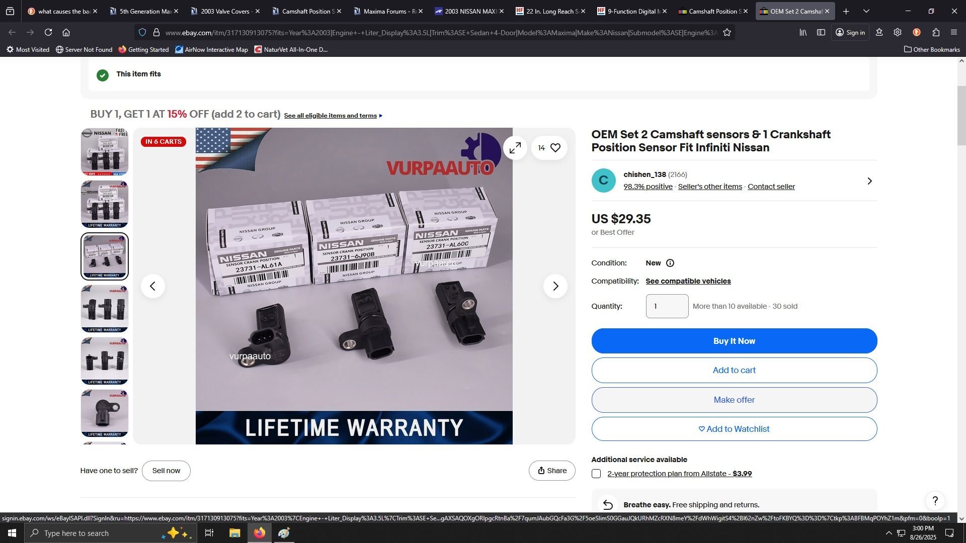

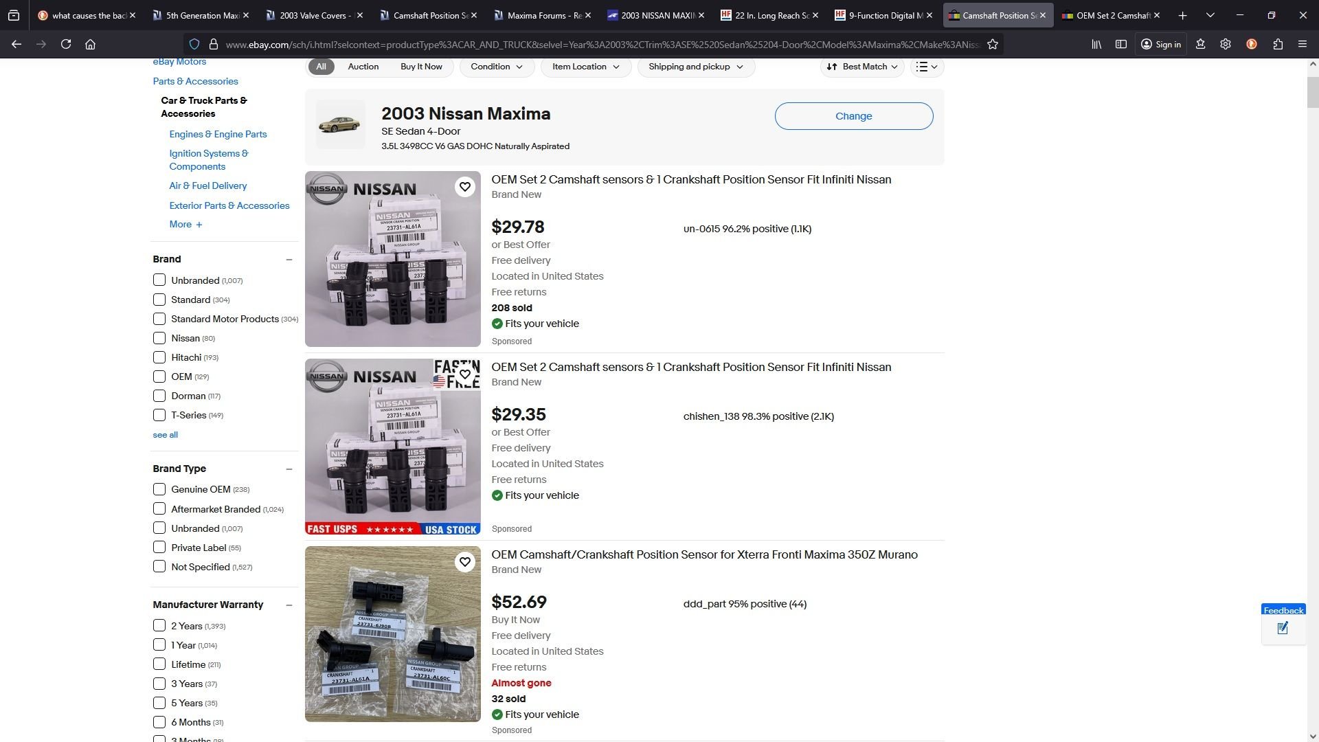

I don't understand why on Rock Auto there are 3 cam position sensors and 1 crank position sensor. All 4 sensors are unique in design. I think those combo packages on Ebay are legit. I don't know for sure if there the same as member from East Los Angeles that bought from a seller in Corona, which is east of LA by 45 miles or more. The parts look legit, at least in the pictures they do. There a lot cheaper than Rock Auto.

at that price those 3 "oem" sensors are most definitely counterfeit.

stay off eBay and Amazon when it comes to engine electronics and fueling
there's only 2 cam position sensors, one for each intake cam and 1 crank position sensor which reads the flywheel...

Definitely fake as F***
Or the old original defective units that were TSB'd off the Stealership shelves and someone bought their old stock inventory and is now selling you trash for you to crash! Beware! Rockauto has Hitachi and they are the real deal!

uptownsamv, could you clarify, just order all 3 Hitachi [Left, Right and Lower] and I don't need that Denso one under Crankshaft Position Sensor in my first picture above^^^

the Hitachi CPS0006 listed as lower in your cart seemed odd but after looking things up that's actually a crank position sensor. for some reason Rockauto has it listed under both crank and cam sensor.
the crank sensor also looks like one of the cam sensors so don't get them mixed up.
