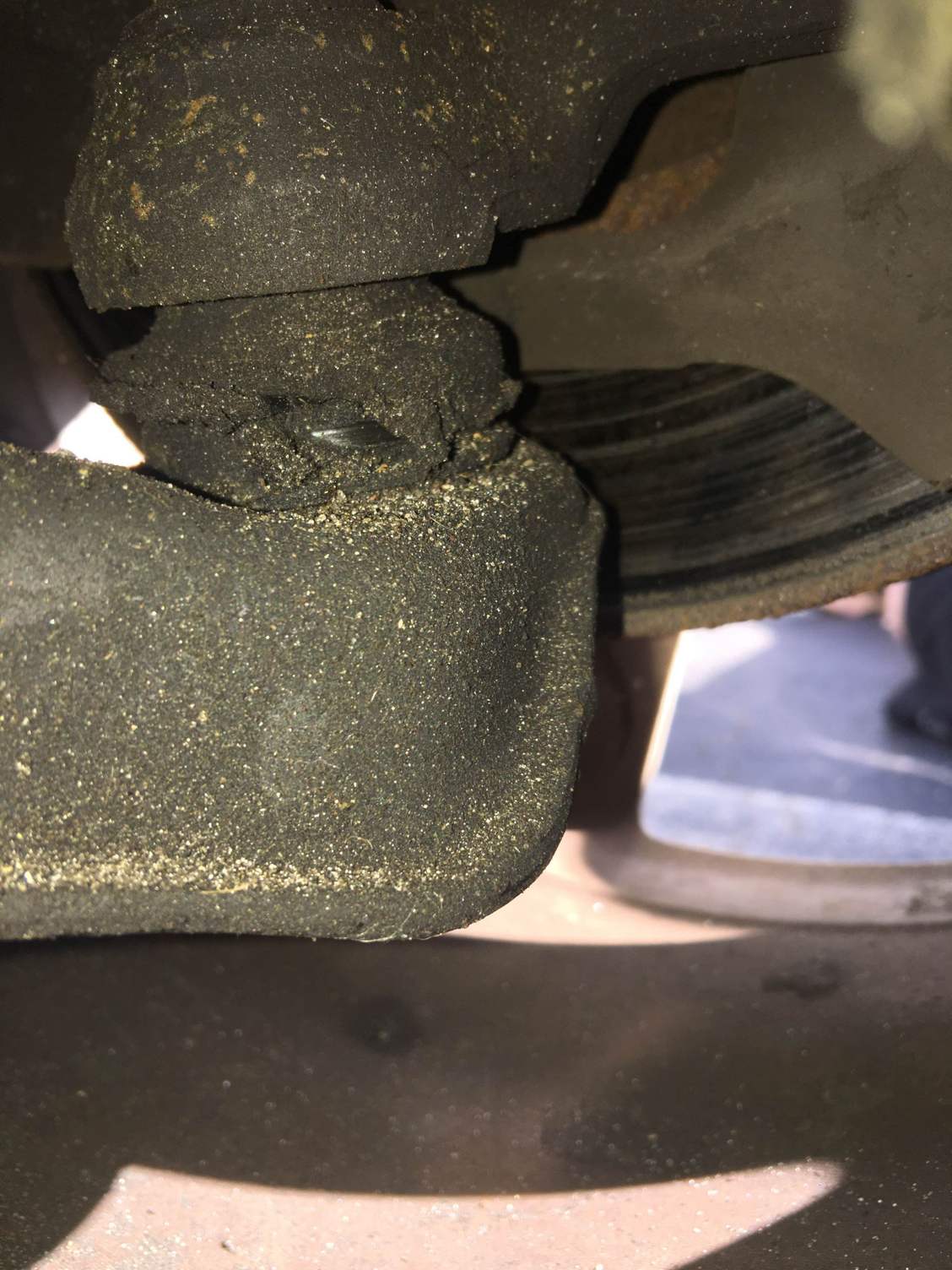

passanger control arm bushing
passenger cv axle is toast
passenger ball joint
She still cleans up nice. would be a shame to junk her

The passenger side ball joint is caked with the combination of cv axle grease and dirt. But that doesn't automatically make it bad. If you are getting a new control arm, it will probably come with a new ball joint.
Another thing I saw in the first ball joint photo is that the cotter pin to insure that the nut won't come off is missing. Make sure you put one on when you're replacing the parts.
