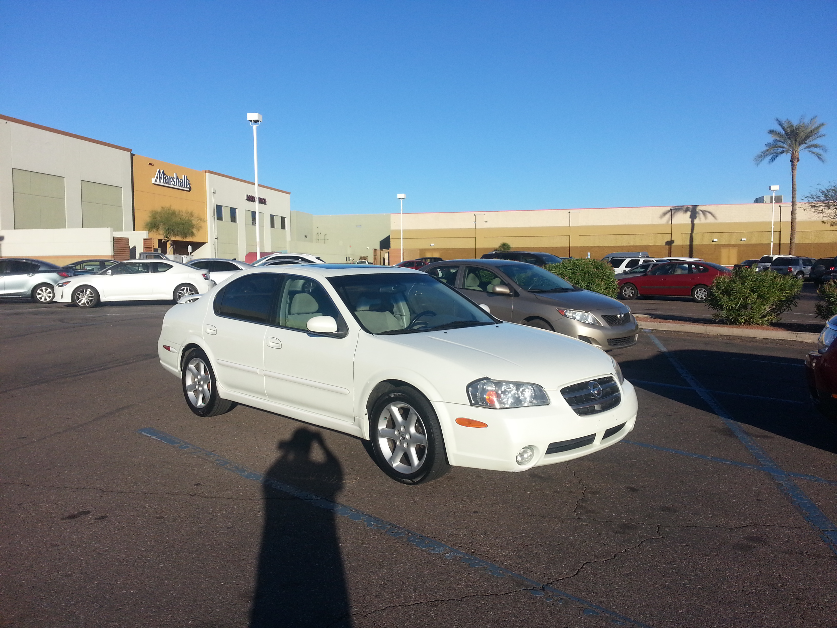

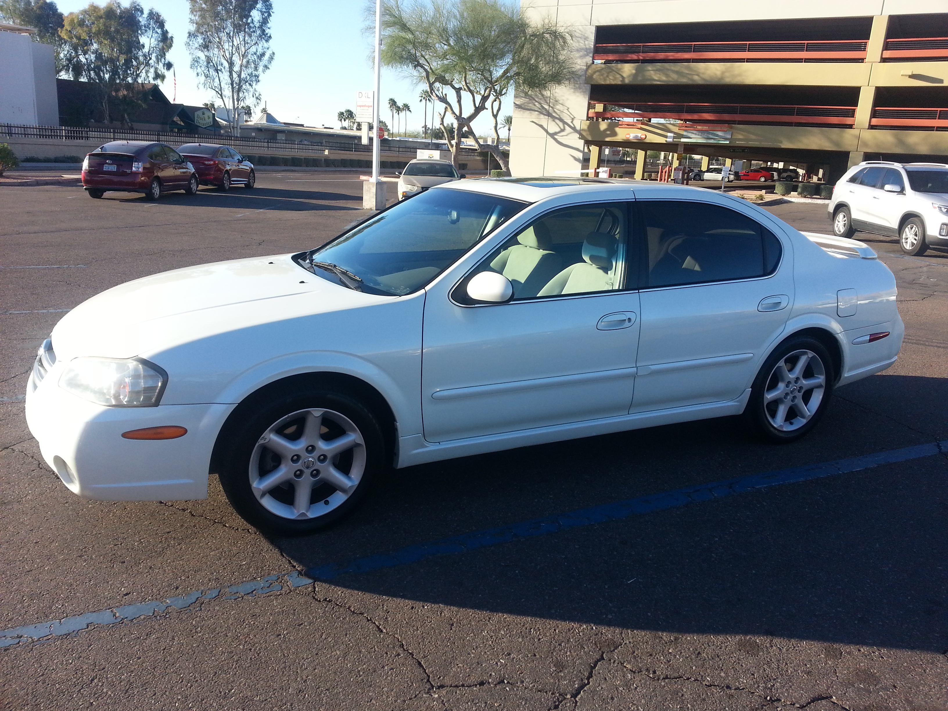

2002 Maxima SE. Fun to drive!

Nice looking car. Not too many nice manual cars floating around any more.

Very nice! Body and especially rear quarters look rust free, that's a bonus.

It's been in AZ all it's life. Has some cosmetic issues like chips here and there and a small scrape on lower front by the fog lamp. Other than that, the interior is clean and rides great. I'm not sure if I should mod it out or keep it stock.

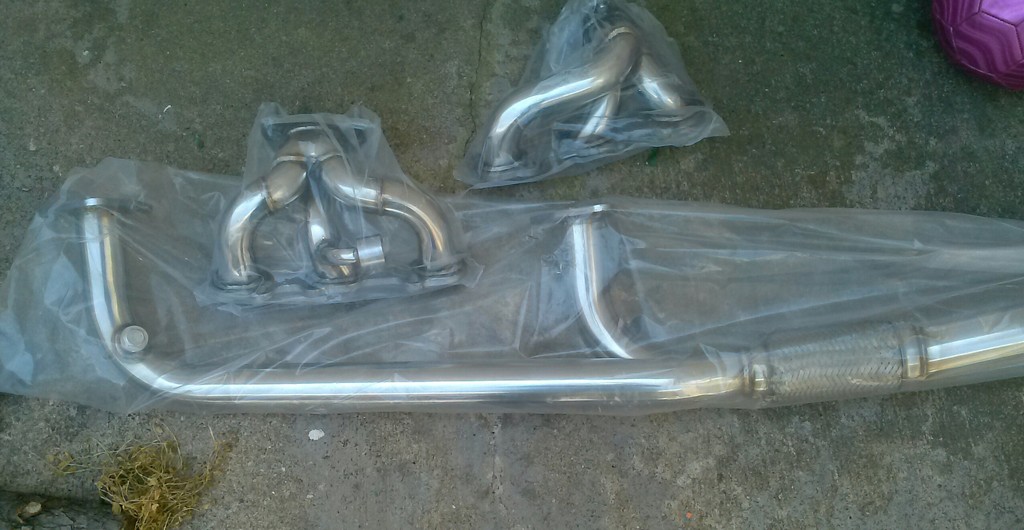

I got these for ya!

I searched and noticed the pre cat failure is common with the 2.5 Altima.

So what's the recommended fix, any links to buy parts? I assume it's new headers?

I bought a set of OBX headers. More power and no more problems

Headers are great b/c of the power improvement, but you can just gut them. The front cat will come out easily (I dumped one out, literally was just rattling around). The rear is likely to be very solid and there's not a wide opening. You'll have to drill holes in it and beat it up with a punch/chisels.
An aftermarket Y pipe deletes the rear cat, right, guys? So, that would be an easier option.
Might as well gut the main cat as well. Get some flow!

Will any codes trigger with new headers? I really appreciate the expertise you guys are providing.

They will. Use defoulers or O2 sim if you can find one. Lots of threads on this.

good luck finding a shop that will remove them/ gut them. Most people where i live wont even touch the rear precat because of how little room there is to work with. Rust/ risk of snapping and breaking bolts. Is that accurate that a new y-pipe will replace the rear pre cat/bank 1. I thought that was only on 5th gen maximas/3.0 engine , not 3.5 engine where the rear pre cat near the firewall can be seperated.
That's why I was asking, I didn't remember (mornings lol).
You're right, though. Since the cat was in the Y on 00-01 it deleted it. 02-03 only bolts to bottom of both precats.
Aftermarkets should have made a version that bolts to the manifolds directly. That would have a been big seller. A Y pipe alone is pretty useless if the cats are still there (unless you gut) LOL.
Both cats should have been in the Y (or nonexistant), then all of this disintegrating precat crap wouldn't have happened. But we have useless emission laws for automobiles. Thanks non-functioning govt!
