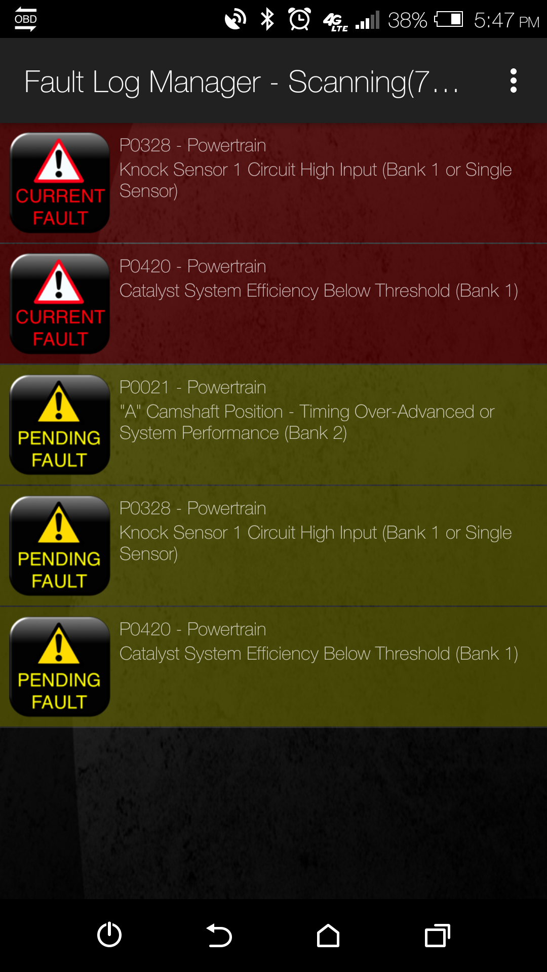

Old Feb 3, 2017 | 02:28 PM
96SEmaxB's Avatar
Joined: Feb 2008
Posts: 167
From: Sioux falls, south dakota
Replaced knock sensor with oem and oem subharness, haven't gutted precats yet, waiting for warmer weather, but i replaced both cam sensors with oem, was still pulling KS code, so decided to do this...
I took my IVT solenoid out and it was oily and one of the plastic orings around the actuator was separated, but not broke, so I just simply pushed it back together and it snapped into place....? Cleaned housing with carb cleaner and checked connection was good, reinstalled and cleared codes...
So far haven't had another code...but it seems like once u fix I've thing another pops up, I guess u can't expect much less from a 15 year old car with 216k on the clock...
