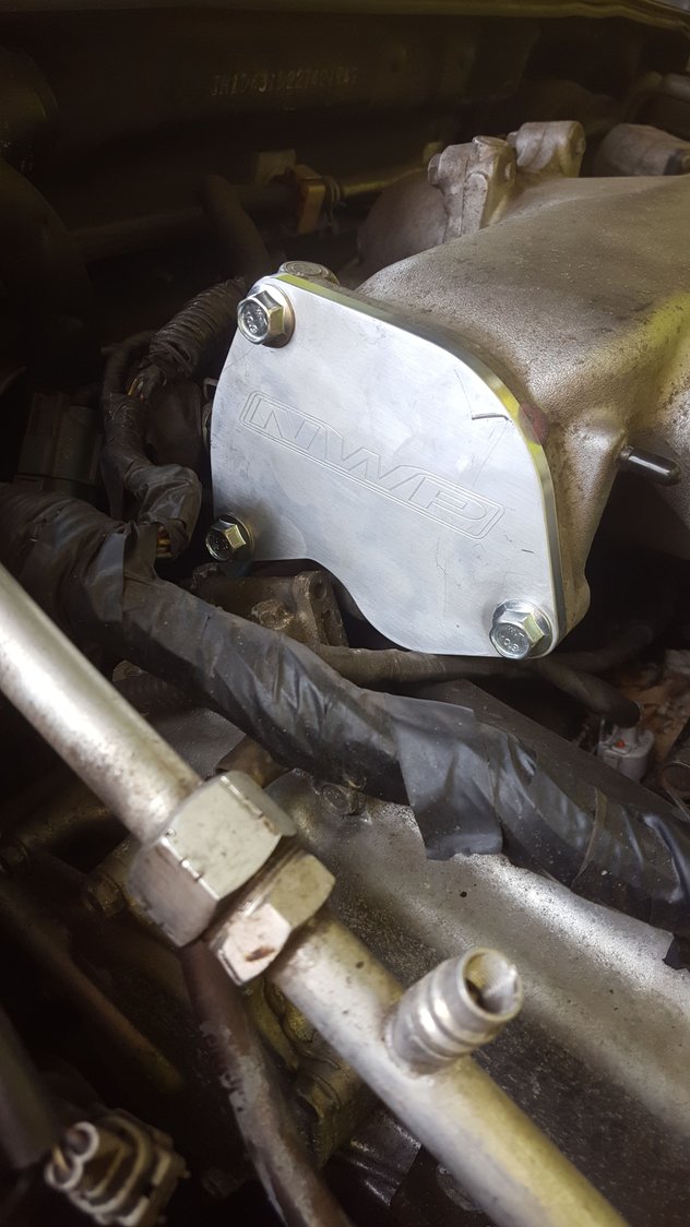

Its beautiful. I installed it today. Not only does my car rip a hole in time-space at wide open throttle, my engine is running better than ever before. The car purrs now. I feel like I'm floating when I'm driving. It is that smooth.
I'm 99% sure I fixed the rough start issue. The old nipple with the vacuum cap was dry rotted and had a hole. Put the new cap on and my idle is almost perfect 98.7732%.
The cats and exhaust leak in my opinion are throwing off the idle by about 6 rpm.
With my engine running this clean and smooth it will last forever. My only concern is frame rust.

That hole must have been sucking air after the maf sensor, which will throw things off most definately. how bad is the frame rust? If its surface you can get some POR15 and apply it. It eats the rust away and was used to de-rust naval ships from the salty waters.
Yeah it was getting unmetered air. The rust looks like surface rust. I actually have POR15, I bought a pint. I'm going to paint any rust in the engine bay. Lower radiator support is getting replaced. Gonna have the bottom of the car rust proofed. May spray the entire bottom with organic apple cider vinegar, let it dry, then have them rust proof it.

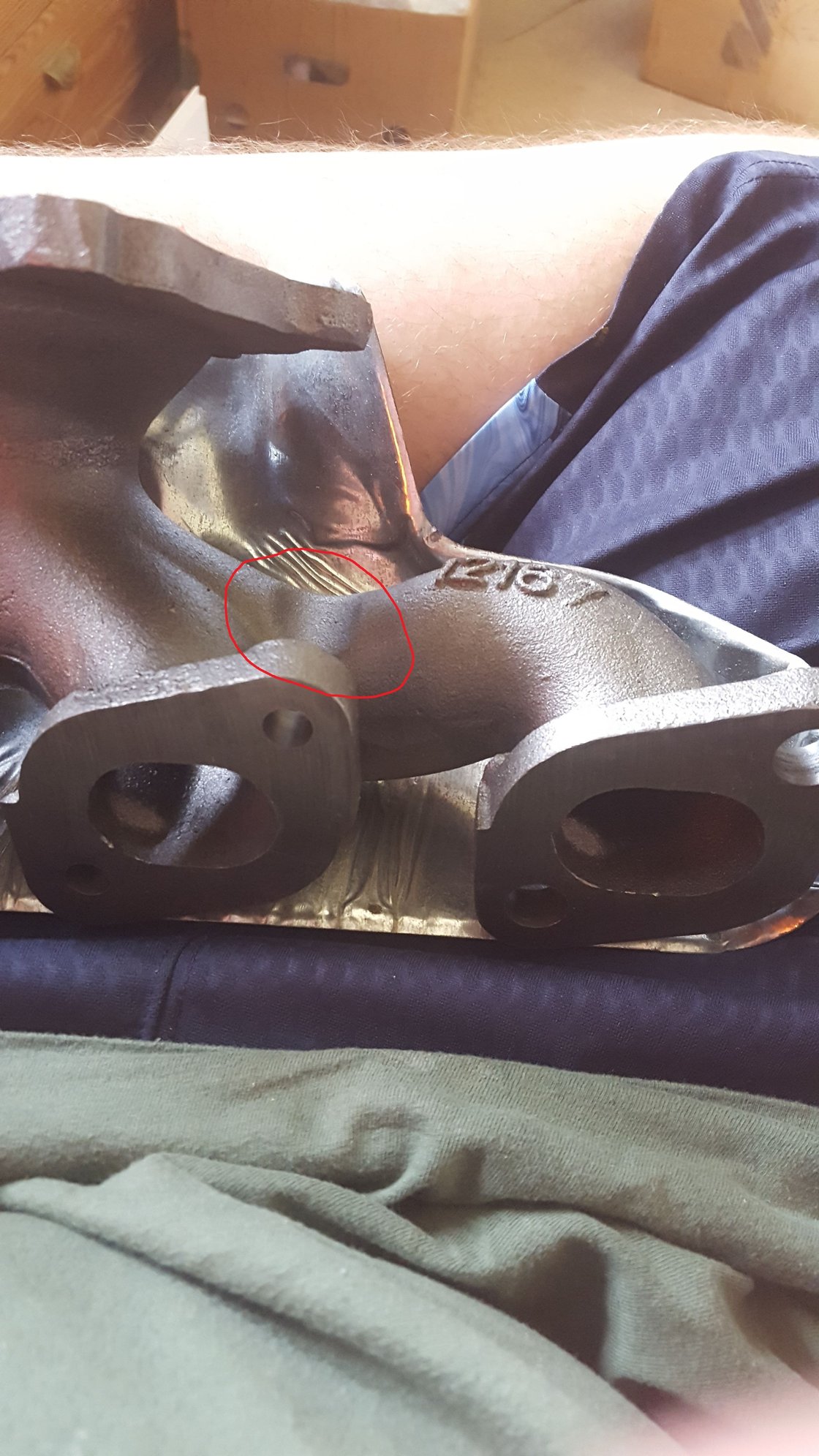

I got both new exhaust manifolds in. The site claimed they have been redesigned in the areas where they fail.
I'm a bit concerned.. There is a big indent on the front manifold. It restricts the air flow on only 1 cylinder. See the red circle in the image.
Also the inside of the bores have lumps, making the diameter smaller.
I looked at pics of Nisan OEM exhaust manifolds, they do not have these limiting designs.
Between the bore lumps and the indent, it is basically trying to choke the engine in my opinion??
Old May 13, 2016 | 09:18 AM
  #109
Child_uv_KoRn's Avatar
Bad *** Newb
Posts: 4,975
It's already choked. This doesn't matter.
