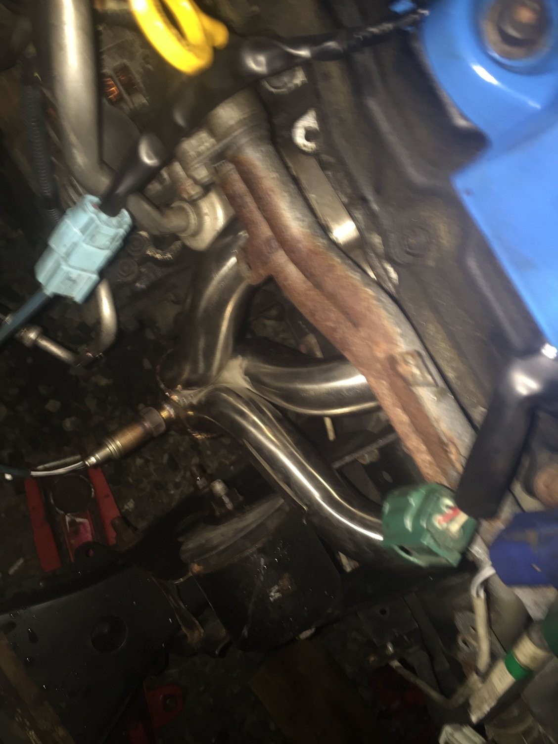

Yea lol the other guy confused me because i just noticed he had a picture of the front upstream
Ok I'll get a picture but off the top of my head I know they're located by the pcv valve. I believe it's a light blue (not positive) connector. Give me 30 min I'm grilling some steak and I'll get a picture.
