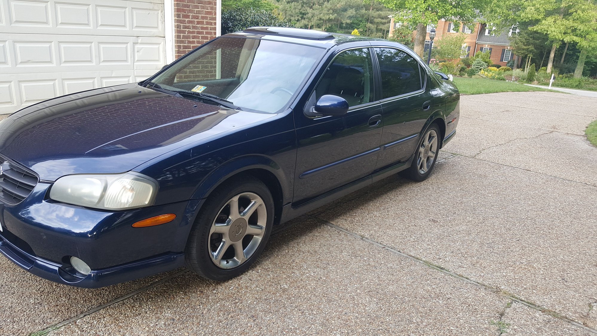

My 2001 AE has 200k, on start up i get sometimes a thick white cloud or a thin blue cloud of smoke. But only on start up! It doesnt smoke while driving. Now when driving it idles high and braking is difficult at times. Im thinking when funds are available i want to change spark plug tube seals along with the entire throttle body assembly. I am hoping i dont have to change the motor. Im also losing oil, maybe its the precat clogged because it runs sluggish at times, no low end power

Any codes? beautiful car btw always wanted a blue one, cant find em anywhere.

Thanks ! I love these bodystyles but i only wish it was a 5spd. I gave it to my wife so i want to get ot running at its best! I know it needs suspension also
