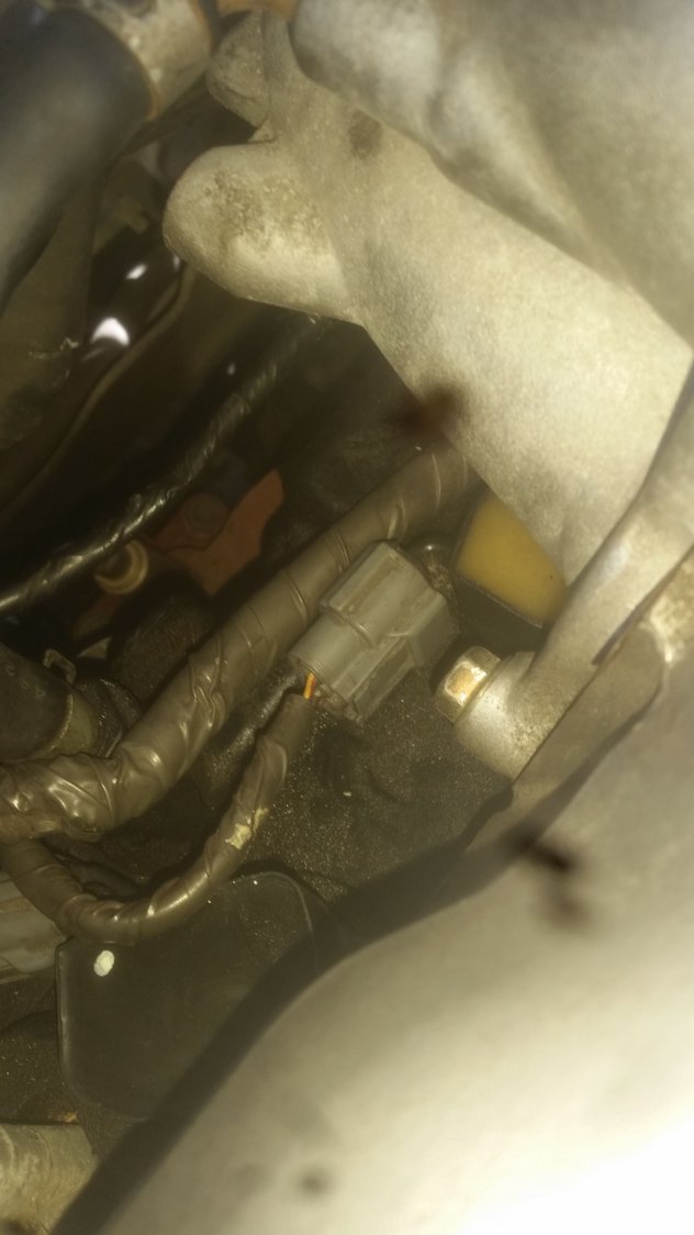

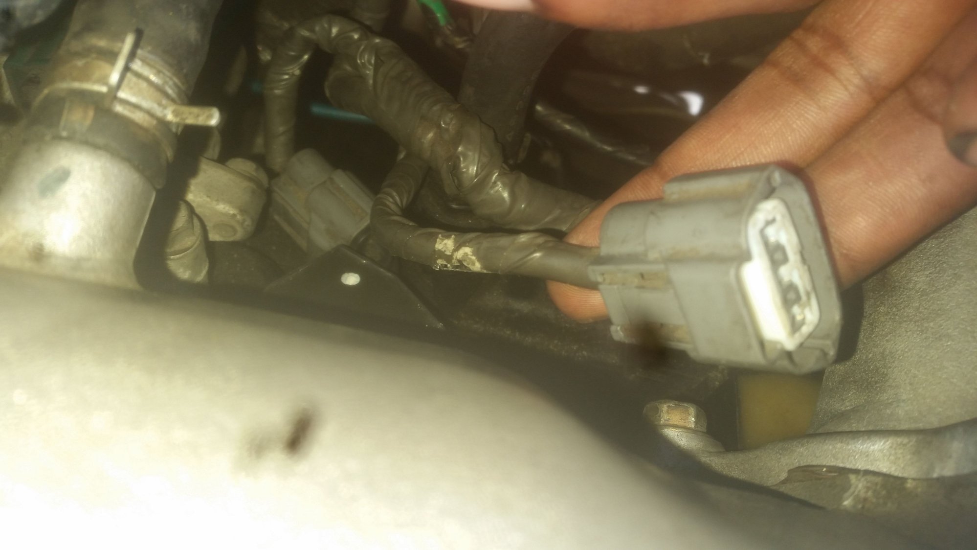

Just an update. I figured out it wasn't 2,4,6 by unplugging then while running the car. I was able to reach in the back of the motor and unplugged coil 5 and no response, so I figured at least that one was bad. I swapped the front 3 with the back 3 and picked up another 2 coils. Now the front 3 are working and 5 is still not working. I changed the spark plugs as well. Could it be the connector to coil 5? If so, would I have to take the intake plenum off again to change that?
Old Aug 17, 2016 | 09:02 AM
MadMax SE's Avatar
Joined: Apr 2016
Posts: 276
Pull the plug on cylinder 5 and post a picture of it.

Update- fixed the misfire by switching the plugs on coils 1 and 3. I guess they were plugged in the wrong order. Car is good now, I appreciate the help you guys.
