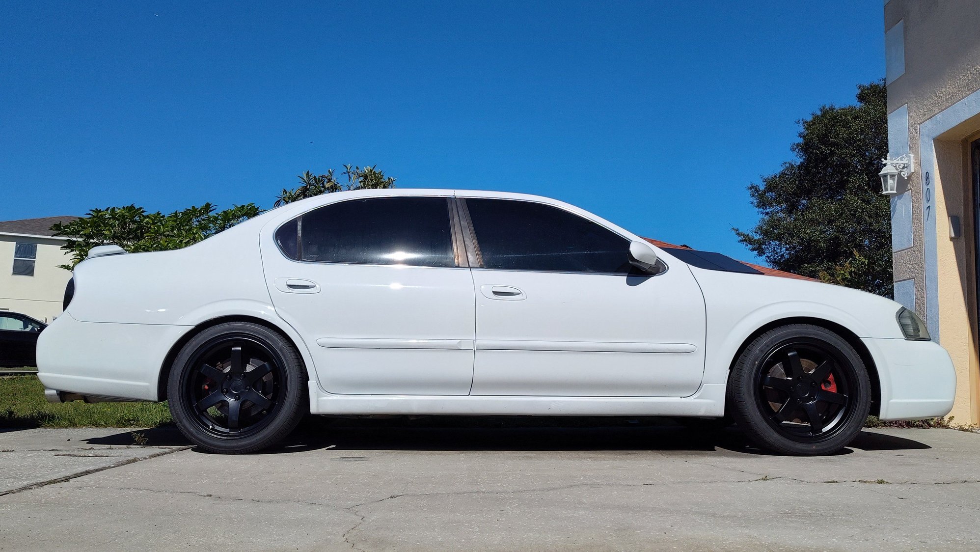

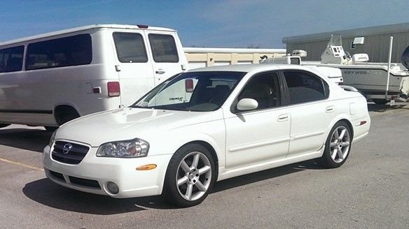

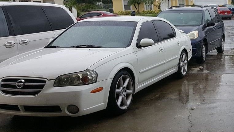

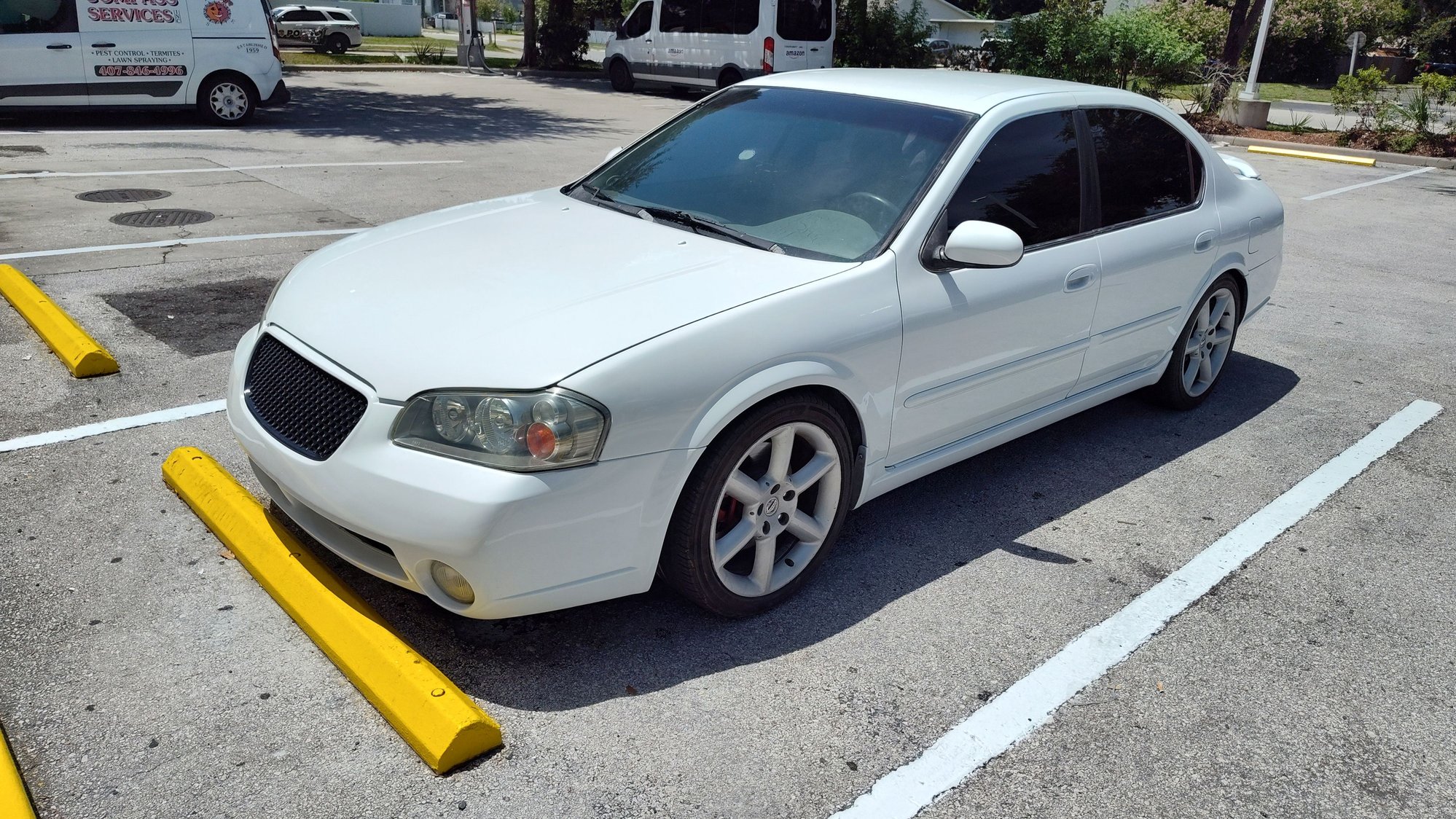

I'm running the same KYB's with Tein S-Tech with 2.2" front drop and 1.6" rear drop and I've been satisfied with it, the drop looks even. before that I was running Megan racing with Gabriel Ultra's 1.75" drop all around and the front had more noticeable fender gap. the Megan springs weren't as stiff as the Tein springs I have now.
drop with Megan 225/45 18 tires
drop with Tein 245/40 18 tires
Tein with new wheels and 245/40 18 tires
