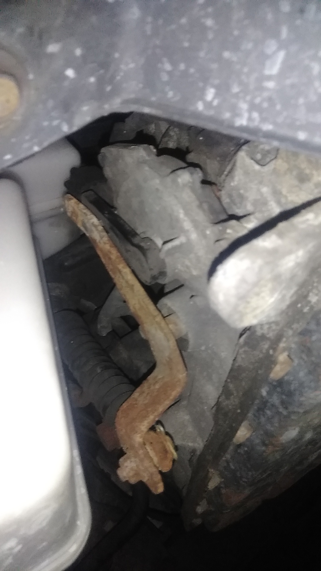

Is this the neutral safety switch?
yep that’s the one looks like you have a lot of road salt corrosion seem like the switch contact might got the same damage from severe corrosion

Try putting some lube on the pivot points. They look pretty dry and crusty.

Thanks you guys for all the help I'm just going to replace it.. Also would any of you know what fuse controls the dash lights?? Because my dashboard lights And park lights not working.
