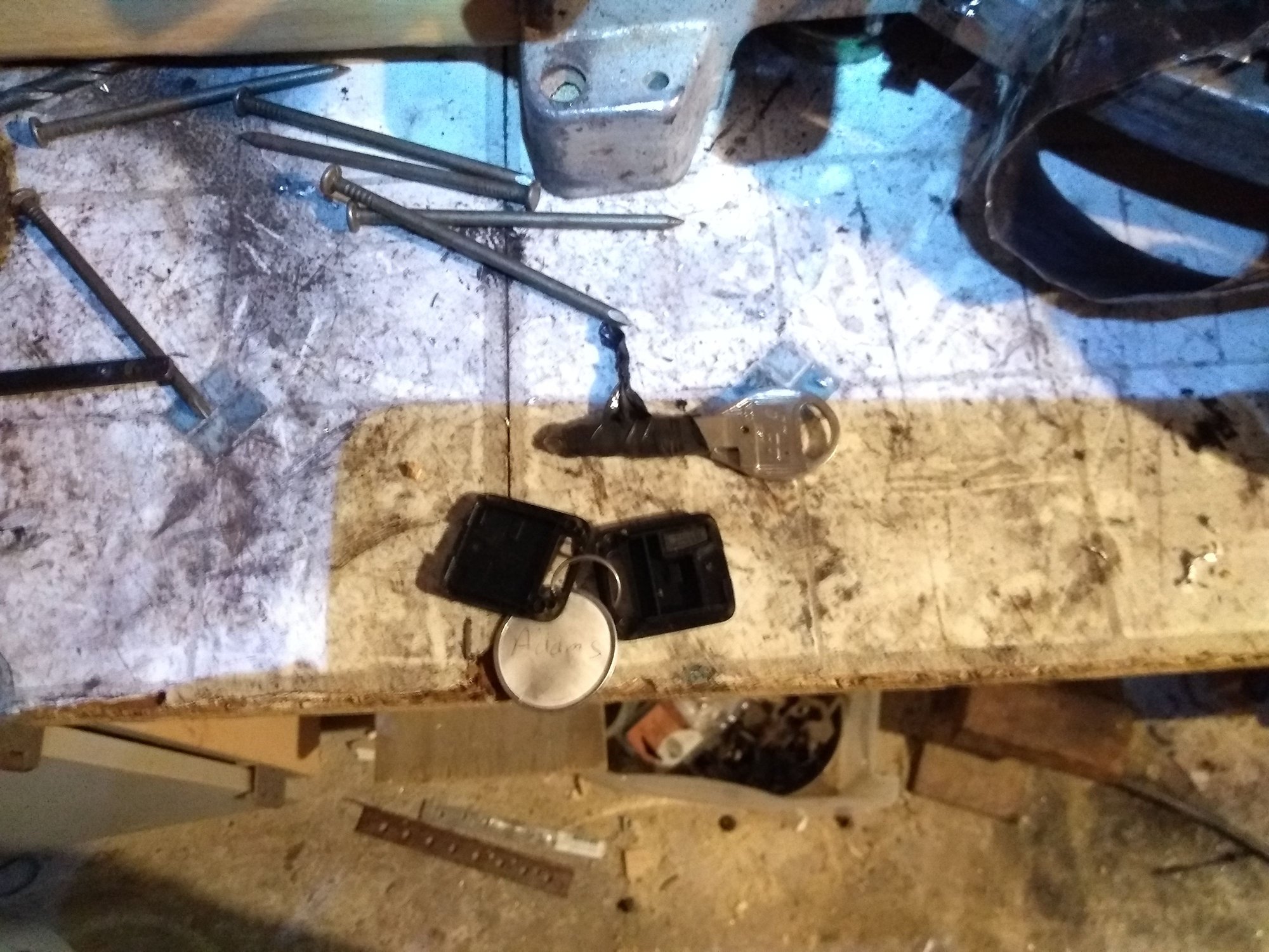

Car ran fine before I lost the key and only needed the throttle feathered upon cold start. I think the iacv has been replaced but maybe not. I'm going to pull it and see. The computer hasn't seemed to rake a hit from it. Is it possible they replaced iacv, had computer remanned, and never relearned idle on the car?
